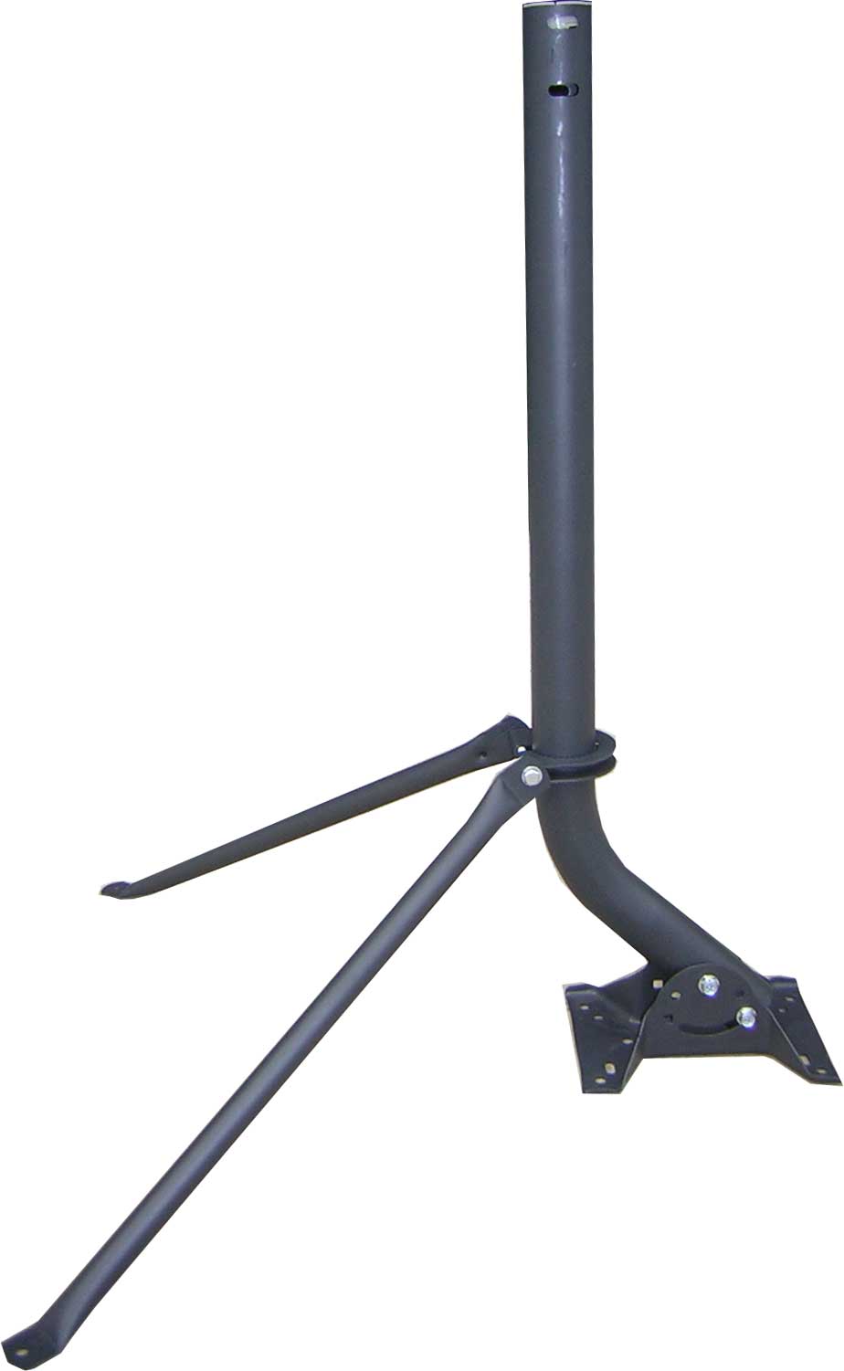

The majority of 90cm and smaller dishes are usually shipped with a 1 5/8" OD post / mast. Larger reflectors often require a 2 - 2 3/8" or larger post. Don't automatically assume that the dish is supplied with a post. Larger dishes often are not.
If you need a longer mast or one with a unique reach or angle, go to a local muffler shop and they will be able to bend a pipe to meet your specific needs. You should try and provide the OD measurement of the pipe and a simple drawing with bend angles and measurements. I will usually take a manufactured post with me so they feel more comfortable seeing an example of a finished product. Before painting the post, clean with a oil removing agent and primer.
If you are going to the effort of motoring the dish, definitely go for a 36" or larger. You will not regret having the extra gain for any weaker satellites or during poor weather conditions.
The GEOSATpro branded 90cm dish offers a unique solution which allows the "J" pole to be mounted by either end. This will optimized the mount for either vertical height or horizontal reach. BTW.... It is available to be shipped from our distribution partner in Ontario.
