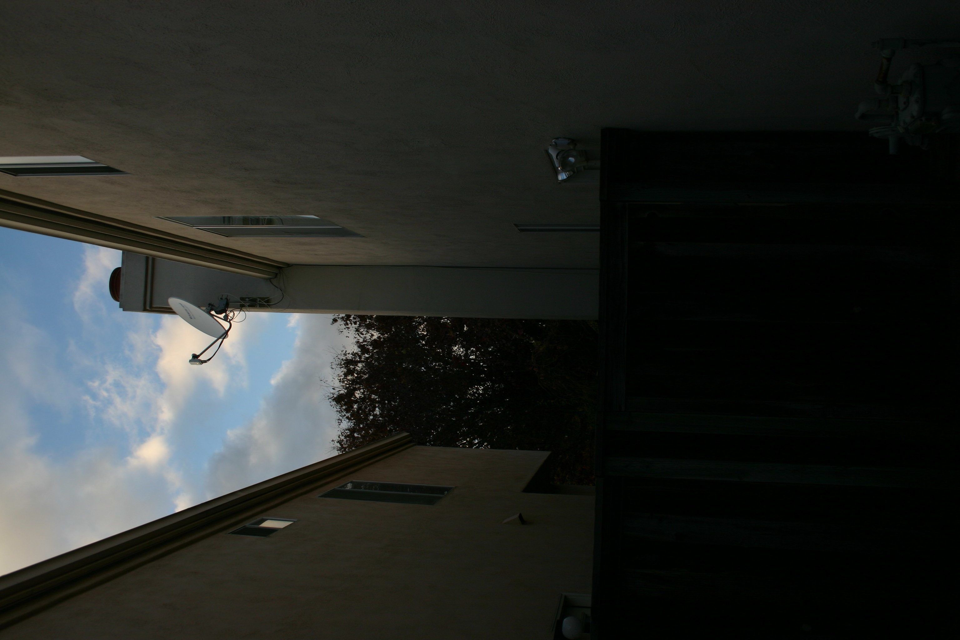

My motorized 90CM is about 22' up and hits 72° through 148° easily, except 82° which I think has a tree in the way. (and I have no need for it anyway)
You need to mount your's a bit better than mine, I didn't have side braces or a place to put them without going even higher. This is stucco also. :(
