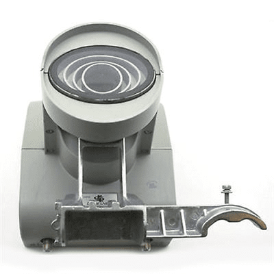

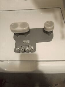

Wow, first, you'd need an Eastern Arc DPP 1000.4 Dish and LNBF and a 1000+ Dish/DP 500 LNBF. Has to be a DP not a DPP pointing at the 118.
Then you'd run three cables from the 1000.4 LNB to the 42 switch, ports 1,2,3 out to ports 1,2,4 in and 1 cable from the left output on the DP500 LNB to port 3 in on the switch
