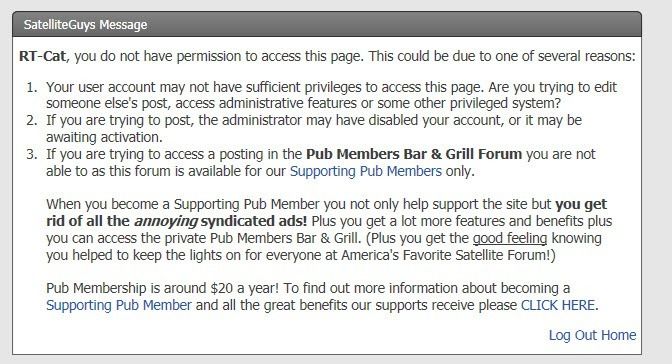

No problem here on Firefox! I went there before I responded to Charlie. Nothing to do with what Charlie needed. It was 99 C-band channels Fatair was looking for.
Catamount
http://www.satelliteguys.us/threads/325827-Hidden-channels-103W?p=3323759#post3323759 works for me.
here it is without being a link so copy and paste: hxxp://www.satelliteguys.us/threads/325827-Hidden-channels-103W?p=3323759#post3323759 Don't copy hxxp:// It's in the WUT so ?????????? as you are pub members??????
post3323759 has the attached file with the pids for the audio channels in question. No longer necessary as you've posted them here.
