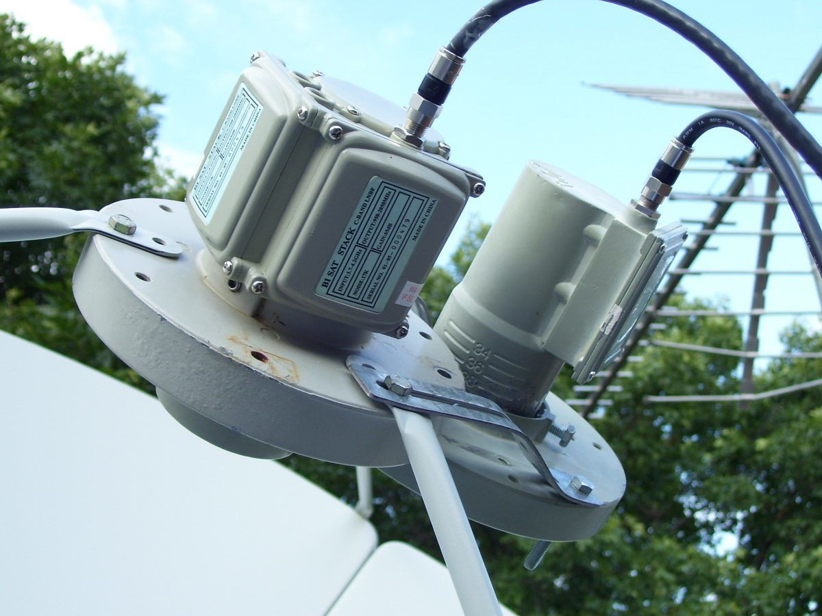

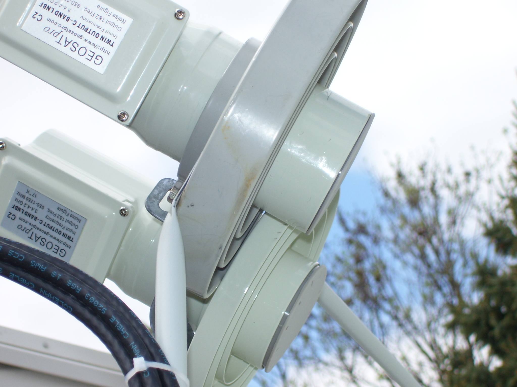

it seems like in some cases to push the LNB towards the dish helps reject adjacent stuff
I do that with my 6 footer and G16 C-Band. LNB is pushed in pretty far
Hmmm, thanks for the tips Iceberg. Will have to try that. I miss my RTN fix.
couple examples
the 1st is the stacked LNB on the left...the LNB is almost pushed in as far as it would go
2nd one is a GeoSatPro dual (same sat)..notice how far its pushed in
