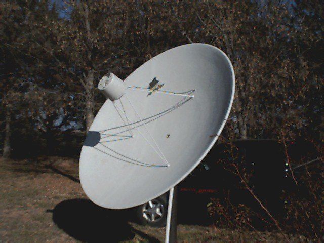

This thread has peaked my interest in Birdview once more , I have a 8-9 ft Solid White Spun Aluminum Birdview Dish in the garage with mount motor and post , so whats keeping me from installing it .
#1 missing feeder Tri-supports
Originally mine , left it with the house when we moved in 89-90 , I had passed by the house many times , they had it pointing straight up filled with soil and was being used as a flower bed, they hacked off the feeder supports. One day they tossed it in the alley and my brother brought it home.
Come spring I'll check it out again , do the string test to see if it's warped , I would have to retrofit the supports , I'm a little intimidated by the task, I underestimate myself but I think I can do it.
Any ideas ?
This is not mine , just a pic I found , but it's exactly like it, minus Feeder supports hacked about 2 inches away from dish.

Problem #1: missing feeder Tri-supports
Can be duplicated, but someone will need to supply you with dimensions. The original feed mount wasn't adjustable. The installer just had to bottom out all the fasteners and it was dead on. You may need to design some adjustment into your new one.
Problem #2: filled with soil and was being used as a flower bed
Sounds like a scene from "Planet of the Apes". Some people have no respect for technology or fine craftsmanship. Good idea to verify it's accuracy. I hope there's no corrosion from it's stint as a planter. Keep in mind that it's aluminum and your new feed needs to be aluminum also. If aluminum is a problem, stainless steel could be used. Carbon steel (painted or galvanized) is not compatable and should be avoided. Electrolysis is a problem at all contact points with dissimilar metals. You can use plastic washers and caulk but you'll still have a potential problem over time. If you're near a coastal area, the electrolysis problem would be much greater. My old dish had an asphault gasket between the dish and the painted carbon steel HH mount.
With a little effort on your part, you'll have a dish that will give excellent service for a long time.
