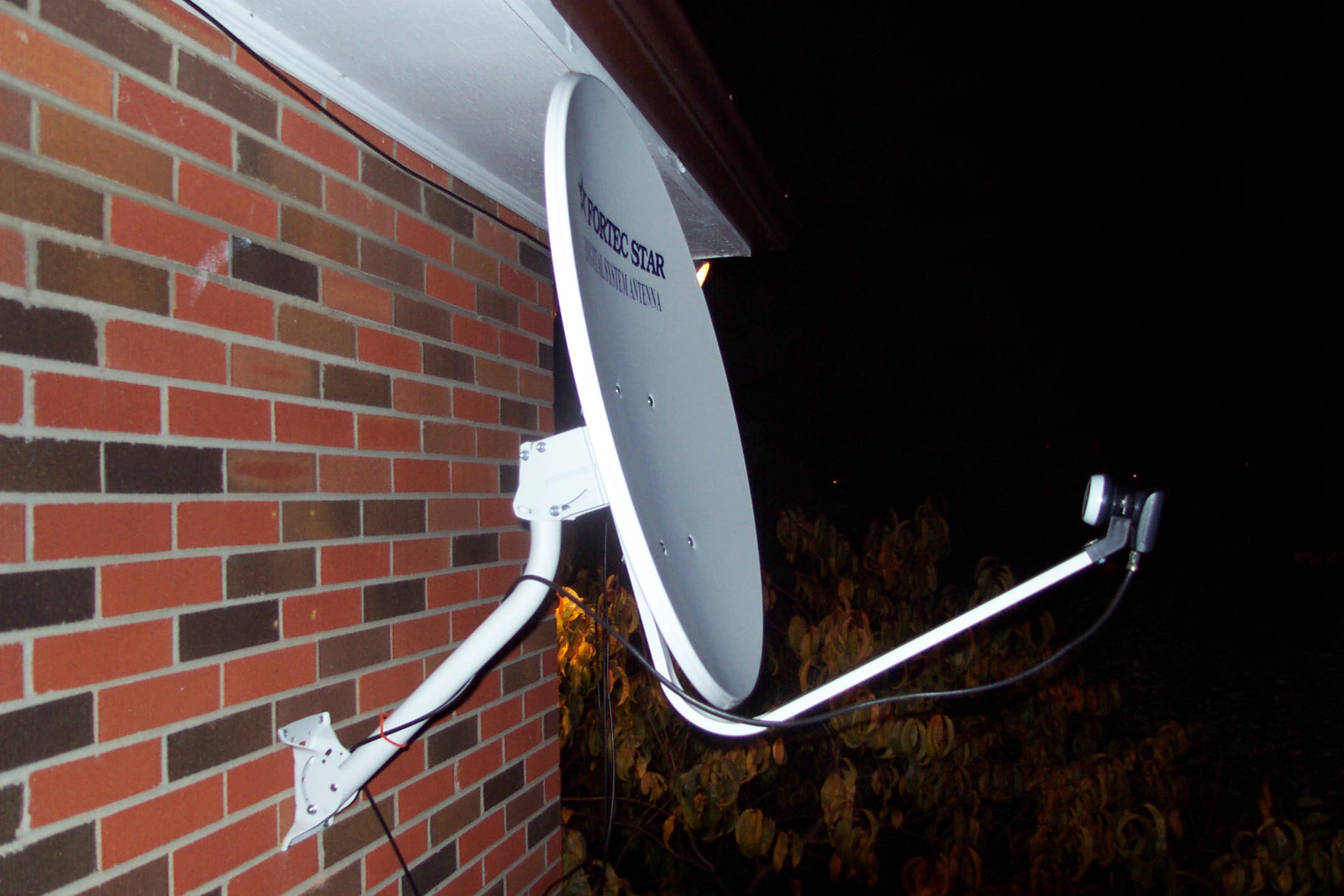

Since it is on Lyngsat I will post it in the main form. Is anyone else experiencing a low signal from WB-38 New Orleans? I get 45-55% quality. Although, I saw the Critic's Choice Awards last night and the quality hit about 88% all night.
I have a 80cm (Fortec star Model FC-75) dish, will upping it to a 1.0m help out? I really wanted to put up a 1.2m dish but the dish would then hit the soffet of the house:( (it just sits underneath to get height). That being said, I will install a long steel post (to give height and see all birds) away from the house and install a 1.2m Fortec star dish in the spring. But, since I have room for at least a 1.0m will it be any benefit in the meantime? My true north satellite is AMC-5 and the NYN (New York Network) comes in at 98% quality so I know that the dish is aligned properly.
Oh and will a 1m fit on a the reflector brackets of the fortec 80cm Dish or will they have to be removed and use the 1m dish brackets? Please bear in mind that the current position of the dish only allows me to see satellites from Echostar 6/8 in the west to PAS-3R in the west. I have huge pine tree that blocks anything west of Echostar 6/8.
I was thinking again about the 120 cm dish, now if I could find a way to sort of put something in between the Dish and reflector brackets so that I could clear the soffet of the house then a 120 cm dish would fit. But, if I do this will I screw up the signal? I've attached a picture of was I mean. Now this picture is over a year old and does not show the SG2100 motor and the wall side supporting rods, but they are there. The motor gave me clearance better than without. But not enough. This picture will give you an idea what I am up against, any suggested would greatly be appreciated. Since the weather is unusally warm in Toronto for the next few days I would love to get this project completed.

SBS6 vertical transponders have a really odd footprint. The farther north you go, the worse it gets (the Horizontal ones are pretty good)
I'm in Minneapolis, MN and can pull about a 60-65 on average with a 30" dish on that transponder.
But a bigger dish will help :) and yes the 1m dish will work on the same mast as the 80cm

if all you did was swap the dish, hopefully the motor was on your true south when you ripped the old dish off.
The new one should just pop right in at the same angel :)
If you are saying you kept all the 80cm parts and just swapped out the reflector it may not work at all.
The focal distance will be messed up. I am think if you swap out everything it will work fine.
