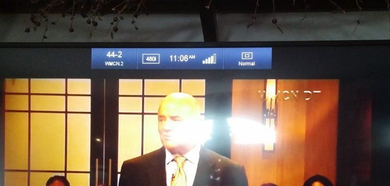

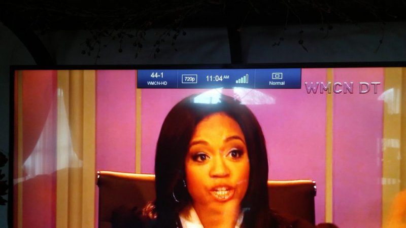

Glad you got it figured out. How are you receiving WVIA ch 44? Starting a few weeks ago WMCN Princeton, NJ locks in at 44.1 and 44.2. 44.3 still locks as WVIA Create. Apparently WMCN is also broadcasting on virtual ch 44 but with them sharing WHYY (Wilmington DE) ch 12's transmitter there's no way they should be overriding WVIA here in NEPA.

In effect they do even though physically they don't because it doesn't matter what digital channel they actually broadcast on it's the PSIP that determines where it appears on your TV and both are using virtual ch 44. Rescanning (3 times) does not fix it. The FCC may have screwed this one up. WMCN was originally located in Atlantic City NJ but when they sold their freq they reached an agreement with WHYY to share with them. WHYY doesn't reach AC so the license was transferred to Princeton NJ and WMCN continued to use virtual ch 44. The problem comes about because WHYY's signals broadcast northward and I'm not sure the FCC took into consideration that there was an existing ch 44 northward. I can receive WHYY clear as a bell so it's not totally surprising that the shared broadcasting by WMCN also reaches here.

Rescanning by itself won't fix the problem, You also have to manually remove (or "whack" as I said in my earlier post) WMCN's channel 44 from the table that each receiver maintains. I do this for a translator that is on the same virtual channel by design (Oregon has a lot of translators).
If you want both stations, that's a serious problem. Stations are never happy about changing their virtual channel as that is their public face.
For the immediate future I'm going to let WVIA deal with it. I've emailed them about the issue and there is concern that WMCN is costing them viewership which means, since they are a PBS affiliate that relys on donations and fund raisers, that it could result in a loss of income. WVIA would have the most weight behind it to spur the FCC to force WMCN to change virtual channels.
