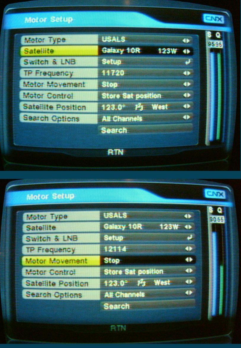

I have noticed the same thing here in the Mid-Ohio Valley about 15 miles from Parkersburg WV. Some of my signals that were around a quality of 95-90 to 80% most of the time some now are down in the range of 50% or so. I was watching a show last night and I got intermediate freezing and break up of the channel and some others. I have noticed it is on a few transponders and not the whole bird.
Like Ice suggested I too bumped the motor and it never helped! The good news is I know that it is not my setup! I am tweaked the best I am going to get so I really don't think it is your box or a problem with your setup LoTech, since we are in about the same area I think it is weather or something affecting it, I have seen this before and I can't tell you how many times I thought it was something here and tried to fix it and it was not broke and made things worse.
It will come back up it always does, just my chime in to say that for me and friends here where I live in my area we watch the RTN bird and they too have low signal and quality on some RTN'S. Got to be something about the area we are at right now! Keep us posted when it comes back up to normal, I will post when mine does!
The pictures show that some transponders on that satellite are low while others are booming in. I called a buddy of mine while writing this before post and he has the same thing going on and he lives in Clarksburg WV and just got off the phone with my brother in Nelsonville Ohio and yes you guessed it, he has some quality issues on some transponders and channels where they were high numbers, now they are half at best. Looks like a duck… walks like a duck! Have a good evening guys!​

Last night (and for the last month) RTN was running at about 65-66 quality. This morning when I got up to watch the Virginian, it was running 70-71.
Tony, do you think it is a geographic thing on certain places in the US for this time of year? WX or something?
I didn't make any changes or move the dish, so perhaps it is some geographic anomoly. Is anyone else getting a boost in signal?
Mine's down to 40/40 now, this morning when virginian was on, it was booming. We still got some pretty good cloud cover with some light snow clearing the area, but it wasn't affecting it earlier! Even the AMC9/3F color bars are down to 80 quality, usually 99.
My quality also changed since last night.Using a ps 150m and a 90cm dish and i was getting around 53-55% on the rtn channels and today there around 63-65% (clear skies yesterday and cloudy today).The color bar channel is also up from 70% to 80%.
mine actually went UP recently...been stuck at 72 and now its flicking between 74-75 on the Coolsat 5000 meter
back up
Checked again on AMC9 , RTN's levels back up , 65-70/99 , don't think it was
weather, I think my motor was off a little when I looked earlier. Its booming again now.
Again this happens at least with my setup every year about this time. I would say it is some geographic anomaly of some kind yes! Ice, mine too went up today on the Jams channel transponder!
When I first got into this hobby, I too first thought it was a set up problem of mine and made things worse adjusting. I have learned a couple years ago that on this bird, this is normal for this time of year and I leave it alone! :up
