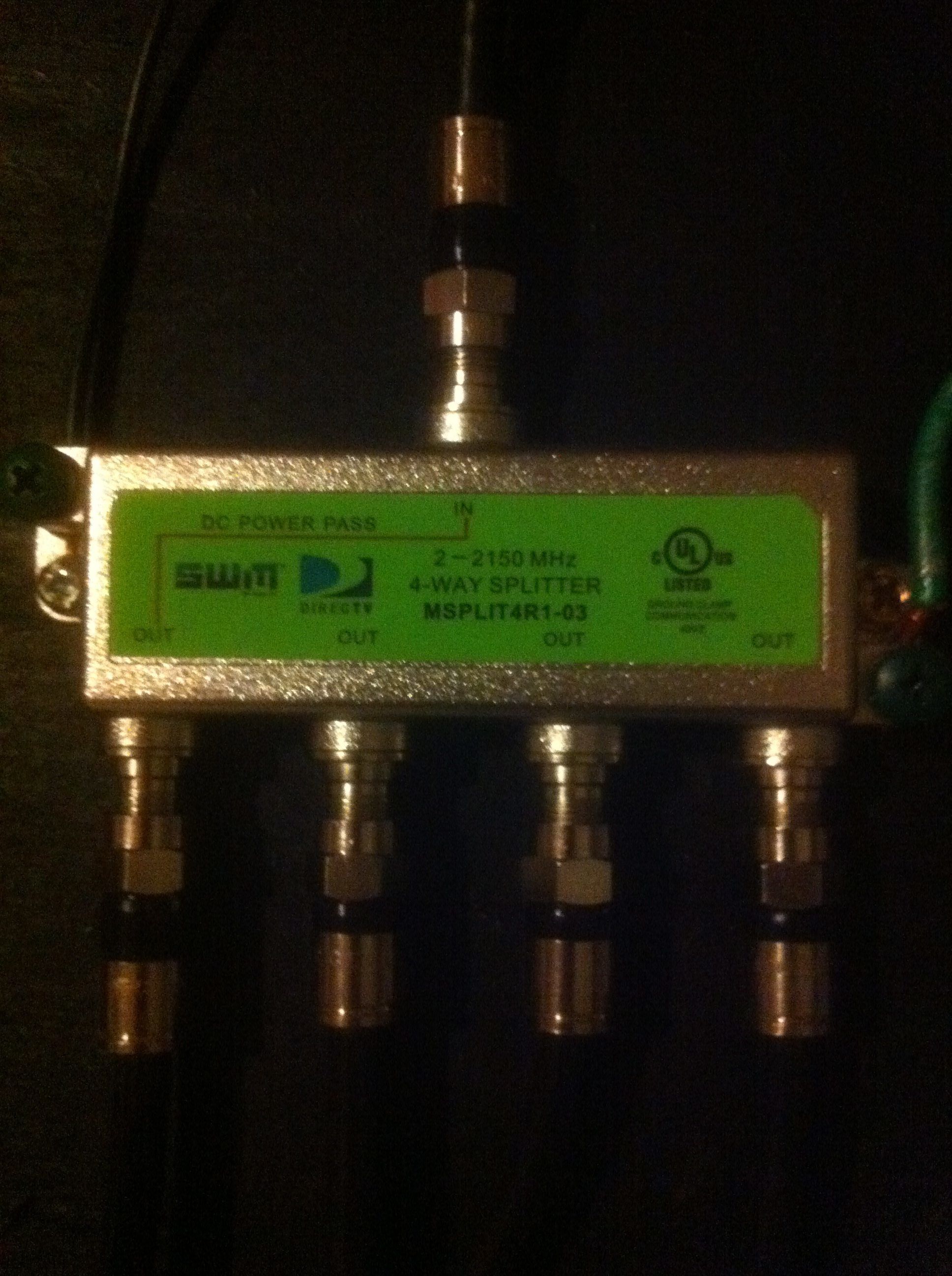

What I don't get is why the box does not work. The Splitter is correctly set up. Line in from dish, First line out goes to PI, 2-4 go to respective rooms. Could the signal be that weak? Bad PI? Bad splitter?

Here is a pic of the splitter.
the PI is connected to the out on the left like it should be.
