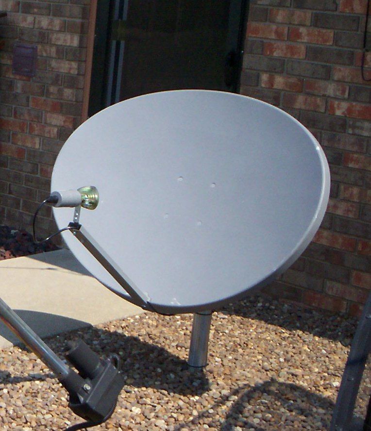

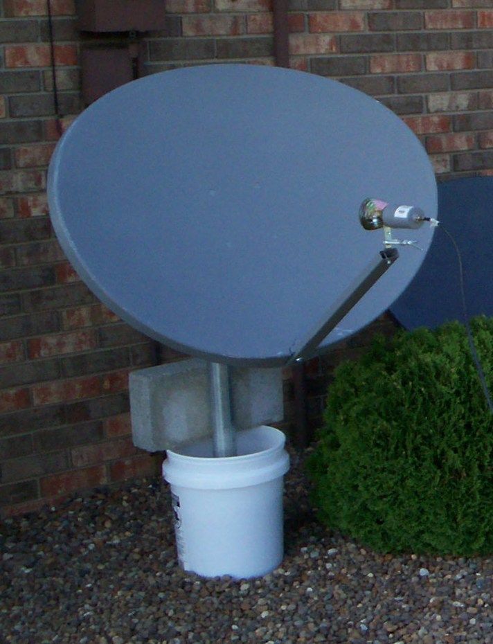

Plant it
Works real well if you plant the bucket in a hole in the ground.
I've got a Primestar 84e on one and it's pretty solid planted just below the surface. I had it setting on top of the ground for a while and it was ok, but a strong wind probably would've knocked it over.
I dug a hole the same size as the bucket, sunk it in, and packed dirt around it, making sure the pole was plumb. Got it aimed at AMC3 and it's awesome.
I used a 5 gallon bucket, a 3 ft fence post and some quickcrete I had leftover. Didn't have enough to fill the bucket all the way, probably only about 12 inches deep.
Planted the bucket so the top of the concrete was just below the ground level and cut off the protruding top rim with a utility knife. Covered the concrete with landscape fabric and rock.
If you just wanted it on top of the ground, it would be best to use a wide / low tub for more tip resistance.
I like the bucket idea because you can move it around to test your los.
