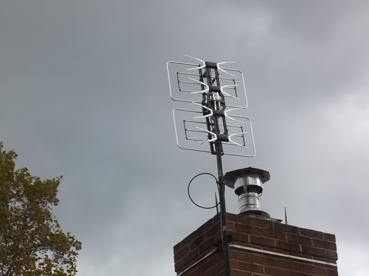

Went through at least eight antennas before finding the best one, a directional antenna with built-in preamp. It worked well in the attic, but it worked much better outside.
