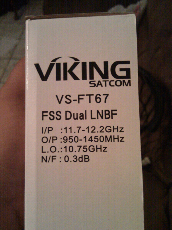

I have a 4.5ft dish and a Viking universal LNB does that works for something?

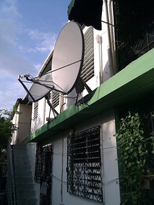

If possible post any info on the LNB(label?). I think it's Ku. And the dish may be a LARGE offset Ku. Great for a fixed 1 satellite system.* Post a picture of the dish. If there is any info on a label or molded into it, post that also. More info=more accurate advice. If you're just starting with your installation, make sure of your LOS before planting the pole. Get the pole, in cement, perfectly vertical. Use good quality RG6 coax between the LNBF and the receiver. Use of "Compression" fittings is recommended.
That is appropriate for the job, if you are in the USA or Canada.
Hey here's the pictures I have no info of the dish but its the same that dish network used here in Puerto Rico before the small ones. The dish is the first one u see and it has the LNB on it

The LNBF looks okay to me.
As for the big round dish in the foreground (to the right), it also looks fine.
It seems bigger than the ones used in Mexico.
The Mexican ones look a lot like the DTV dish in the background of your picture (to the left) :)
