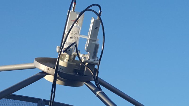

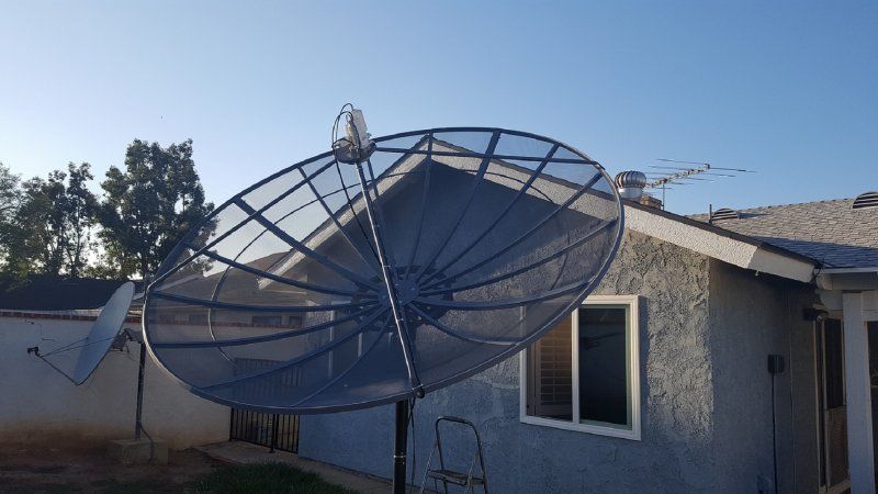

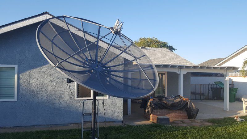

Thanks for responding, I have a Pansat DP-4 FEEDHORN , 4 Norsat lnb's, 2 for c-band and 2 for ku band, they are connected to a WNC 4X8 powered multi switch, the cables are new and the 2 ku lnb's are also new, used 2 different receivers with Enigma 2 software on them and I think the software is the problem, I found a way around it, for some reason it does not like this kind of Feed , I am using 2 tuners on the receivers and if I connect my 1.2 meter Ku dish to one tuner and the C-band dish to the other tuner everything is fine,no duplication's of channels , Maybe I need more information on the settings.
This feed on my 10 foot new dish and is awesome, I am very happy with it. I will try this setup on my Amiko A3 and see how it works.
