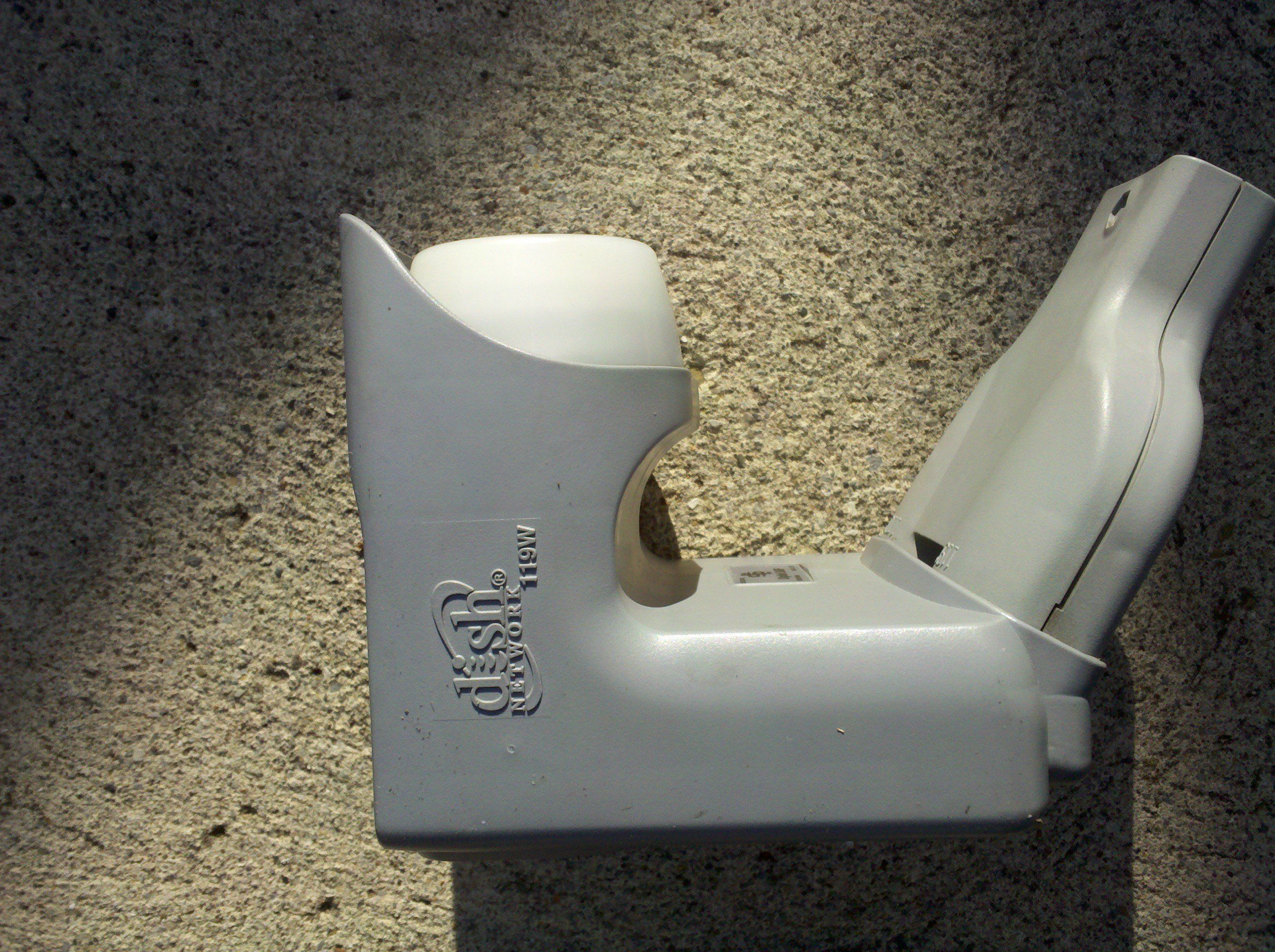

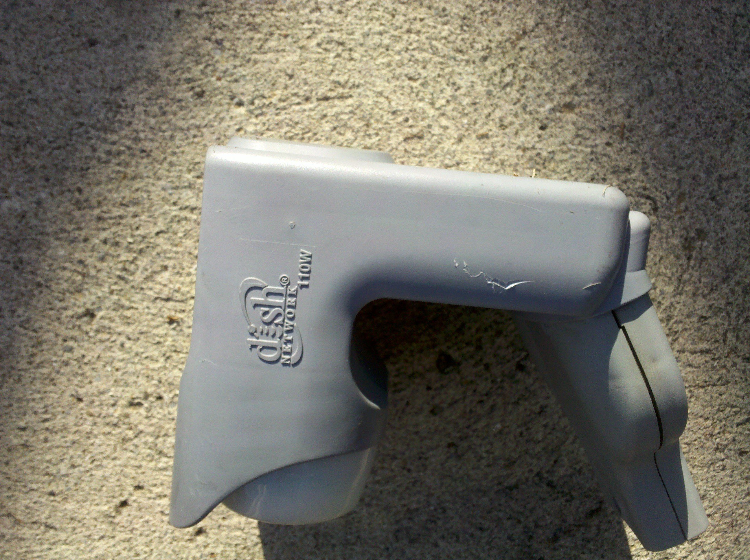

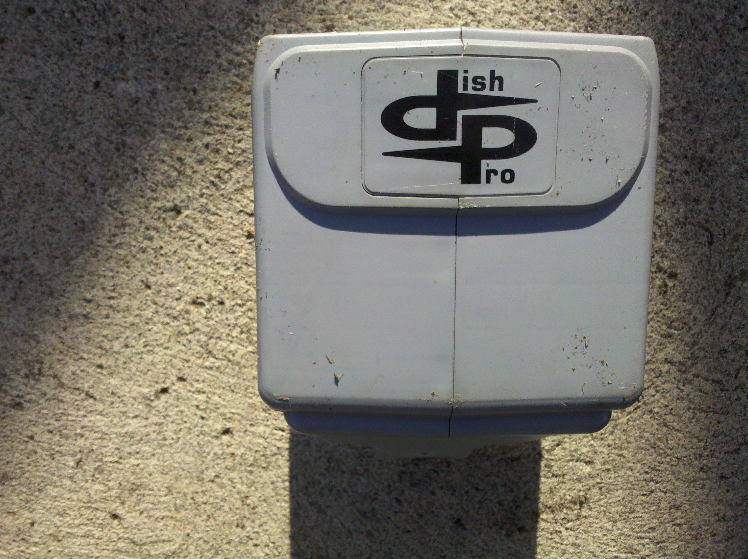

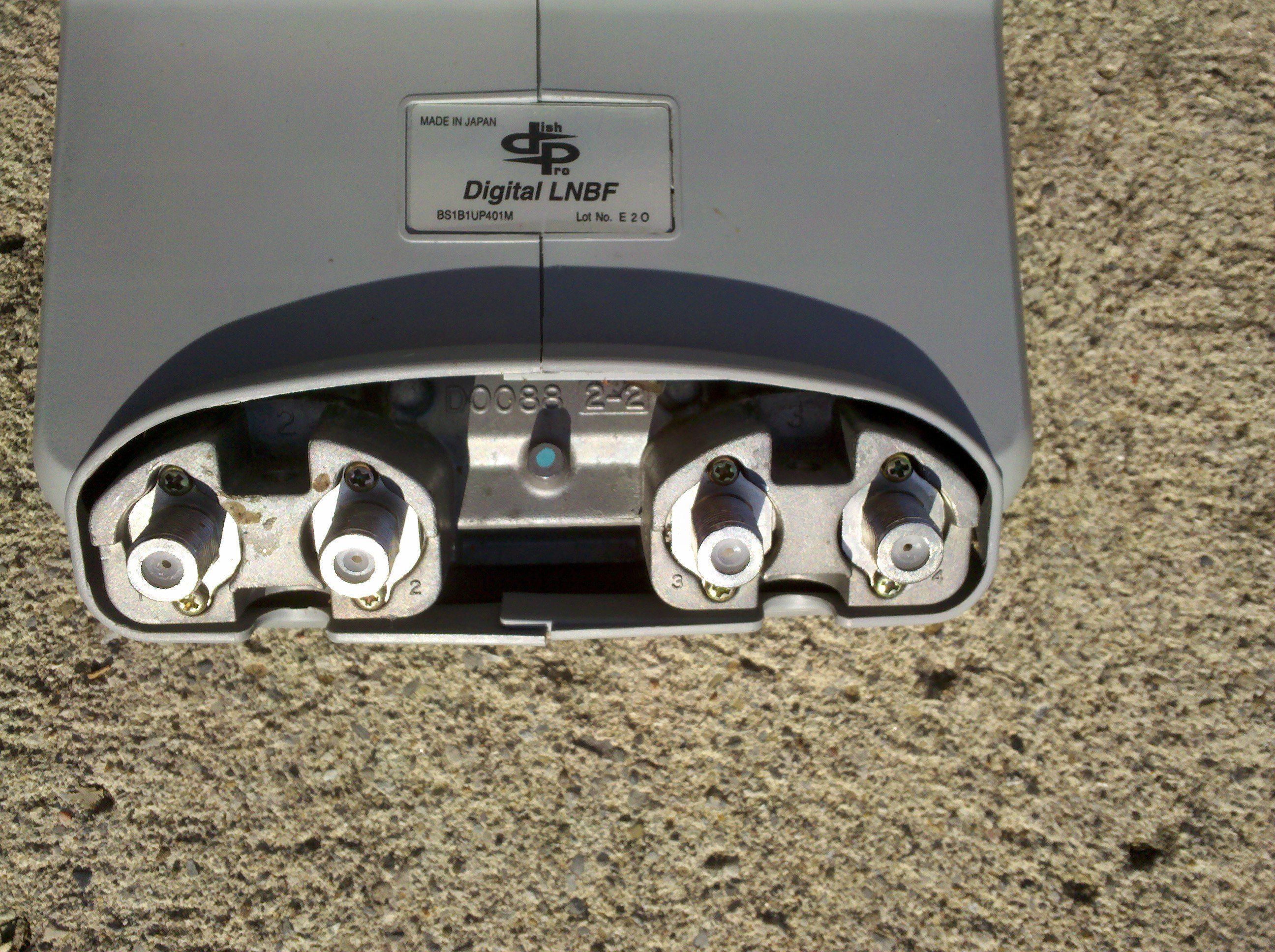

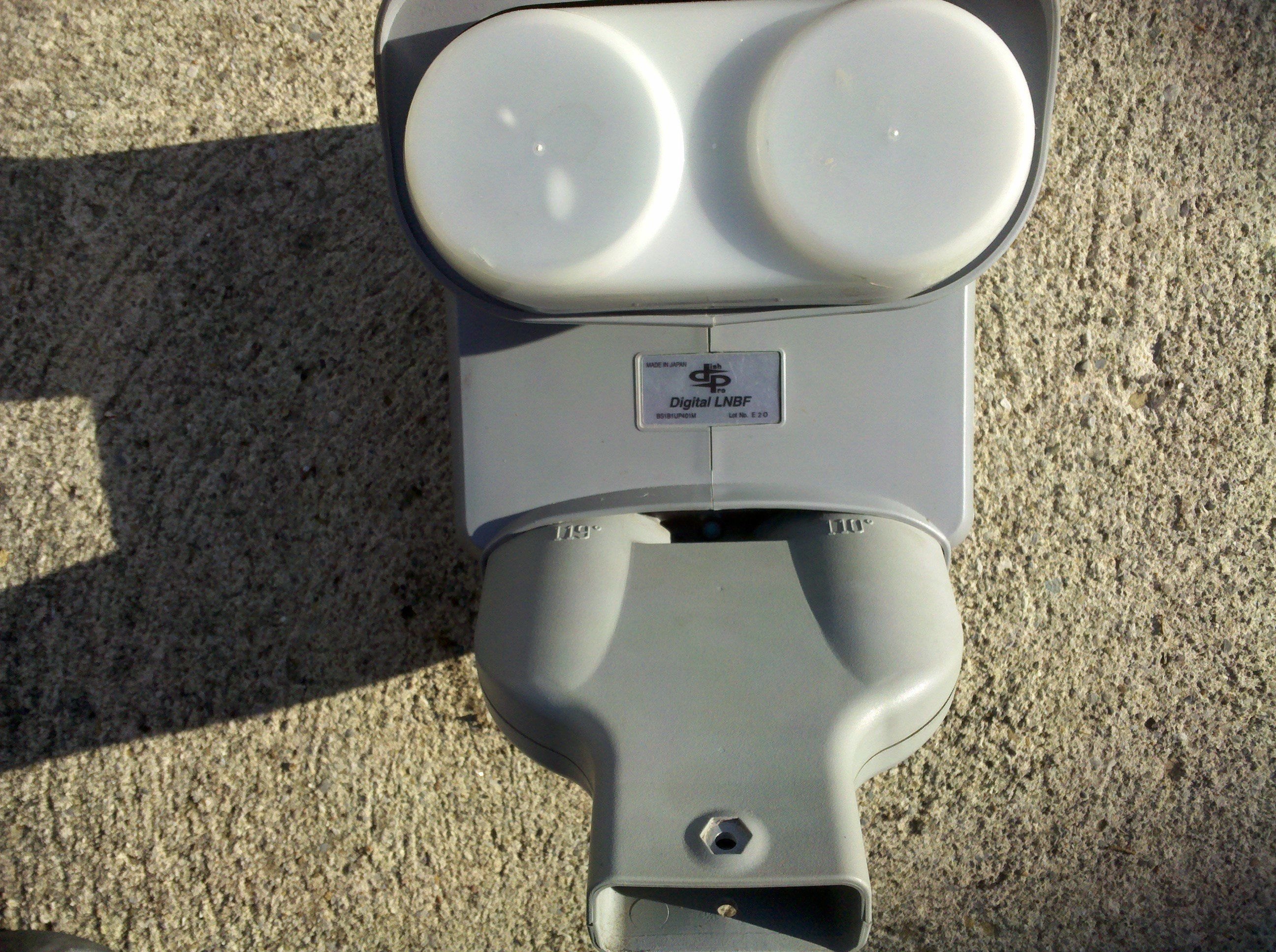

We finally had a day with decent weather, and I had the day off so I figured I would try to get my spare dish working with my receiver. The connections for the LNB do not look as I expected them to, so I was wondering if anyone could steer me in the right direction? Basically, what I have are four coax connections on the LNB, labeled 1&2 on one side, 3&4 on the other. I am not sure if I can just connect one coax cable to one of these and get both 110 and 119 or if I need to connect to both. If I need to connect to both, I assume I would need some sort of switch or something to combine them. If I do need to use two cables and a switch, what order do I go about connecting them while aiming the dish? I have attempted to attach some pictures so you can see what my LNB looks like. Hope that helps.

Anyone have any advice on how I should hook up the dish to my receiver (see post above with pictures attached)? Seems like in a worst case scenario I could connect to either a 110 or 119 jack on the dish, get it pointed to pick that satellite up, and have at least channels from that one available, though I would like to do it right if possible. We head up to camp tomorrow, so it looks like I may have to just play with it once we get there. I sure would appreciate any advice you might be able to share with me in the meantime.
If you do a google search for "How to install a dishpro 500 antenna" You will find some .pdf files with very detailed instructions on how to do it and the switches needed. I would post the web address here but I don't know if that is allowed.
When I got my first Dish receiver instructions came with the antenna on how to set it up and aim it. Dish did not have a network of installers so the customer had to do his own. Their instructions were to first setup the antenna for Sat 119 with the settings in the book for your zipcode, find 119 (you will need at least a compass) and then install the switch. Sat 110 should be near perfect alignment if 119 is right on. Check the aim of the antenna by just flexing it up/down/left & right, and see if any of these motions improved the signal for each satellite. If it did then adjust the dish ever so slightly in the improvement direction and check them all again. I have done several antennas for myself, fiends and family and it is not complicated. It make some time to find the first satellite.

harshness is absolutely correct, the DP Quad does have an internal switch so you will not need a switch. However, the method of pointing the dish is still the same whether you are connected to 119 or both 119 & 110. I did a search for "DishPro Quad" and found a really nice discussion of all the DishPro technology complete with wiring instructions.

Just got back from the hunting trip. I wanted to thank everyone for your help and advice in getting my dish set up properly. We were able to get the dish on the pole in the dark the first night, and after 45 minutes of trial and error we were able to get it properly aligned and working. It was a bit strange that it seemed to think 119 was being received on both sides at first, but, once we got it locked with a decent signal strength, all the channels came in just fine. It sure was nice to have access to satellite channels while camping. Thanks so much everyone for helping out.
