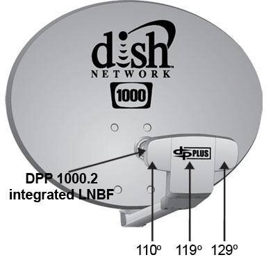

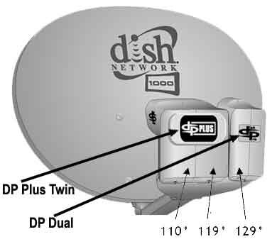

Regarding my advice, do you have a 1000 or a 1000.2 dish? The 1000.2 dish has the 3 eyes in one LNB. The 1000 dish has a DPP Twin and a DP Dual. You could just remove the DP Dual (129) and put it on the second dish for 61.5.

Sounds like you have a 1000.2, then you don't need a switch. All you need is the second dish (D300 or D500) aimed at 61.5 with a DP Dual LNB. You run a cable from the 61.5 dish to the 1000.2 dish and run check switch in the receivers. The 1000.2 lnb has an input for a 4th satellite location. The first dish is a 1000, the second one a 1000.2.
Yep...I've got the second one. thanks very much!:)
