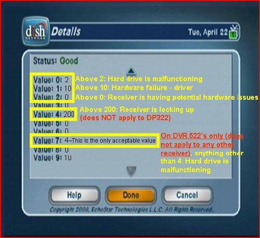

Value 7 is -2 on both of my receivers.
Value 4 is 1 on one and 2 on the other.
One of them also has Value 3 as 1.
I have had both replaced in the past and had a tech tell me Value 7 being -2 was bad.
Thanks for the picture. I've seen similar posts on websites stating Value 7 should not be anything other than 4, but ever since I got my receivers they were -2. Hopefully its changed with a software update.
