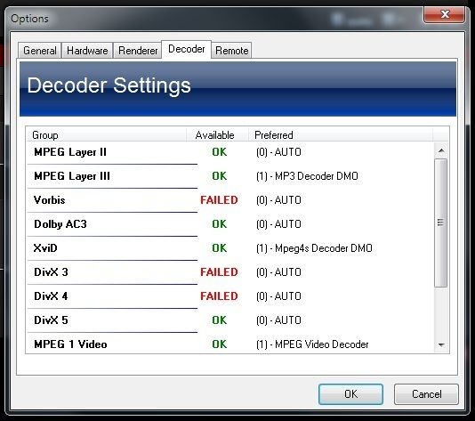

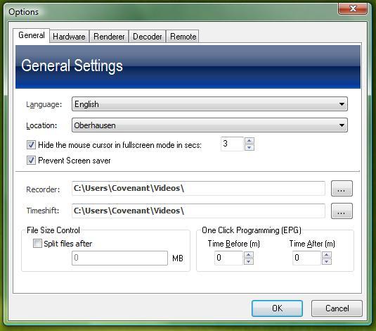

@ dunnsept & trinity13 & all others

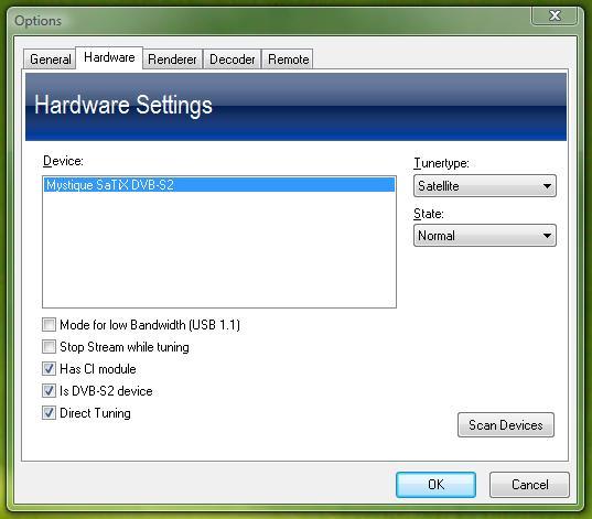

I have received the Mystique SaTiX DVB-S2 HDTV/MPEG4/H.264 on Thursday, 26th March 2009.
After installation of drivers and Mystique TV player, first thing I've done was a complete scan ...
Have to say that compared to other software players, this one looks and feels very good ... if it was just working.

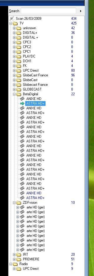

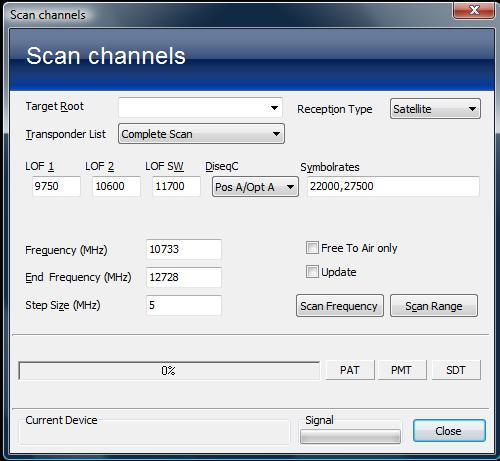

And here is my "Channel list" after the scan ...
1) Astra 19.2 East was part of the scan. This satellite supposed to have a lot of german channels but where are they ?
2) There are a lot of channels showing a black screen only, can I filter these channels as they're probably restricted anyway ?
3) Why are there multiple times the same channels listed ? Like Arte HD (ger) 10 times ?
4) Why isn't there a manual existing ? Some kind of guide that explains the following options ...

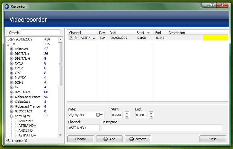

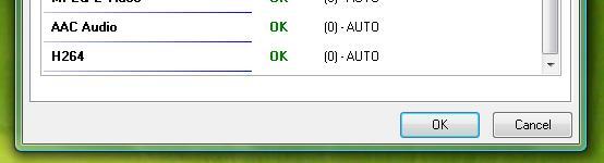

5) The video recording does work nicely, but half an hour recording takes about 4 GB of space (TS file) ... is that normal ?
6) Why is it not possible to resize the windows in order to avoid having to scroll ?

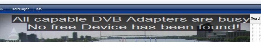

7) Worst thing that can happen is the error showing above. If that happens, nothing works anymore, what is the reason for that ?

9) The vast majority of channels are restricted, like ...
The complete folder "unknown" with 42 channels
The complete folder Digital+ with 36 channels
Another Digital+ folder with 8 channels
The complete CPC3 folder with 8 channels
The complete CPC2 folder with 8 channels
The complete CPC1 folder with 8 channels
The complete PLAYDC folder with 4 channels
The complete DCH1 folder with 4 channels
The complete FL folder with 4 channels
The complete UPC Direct folder with 80 channels ... except one travel channel.
The complete Globe Cast France folder with 96 channels
The complete Globe Cast folder with 8 channels
The complete Globe Cast France with 8 channels
The complete GLOBE CAST folder with 8 channels
The complete Premiere folder with 51 channels
In fact, I can only receive the following channels:
Beta Digital folder with 22 channels: Anixe HD / Astra HD+
ZDF Vision folder with 10 channels: Arte HD (ger) and Arte HD (fra)
IRT folder with 20 channels: Simul SD/HD (seems like a demo looping over and over)
We're talking about 3 or 4 channels only which actually do work. That wouldn't be worth the Euro 80 for the card I think.

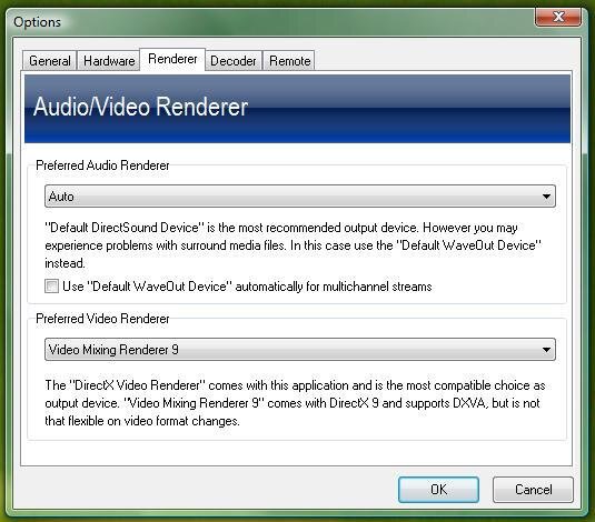

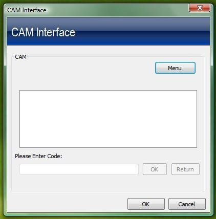

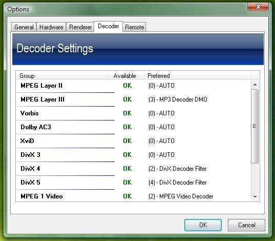

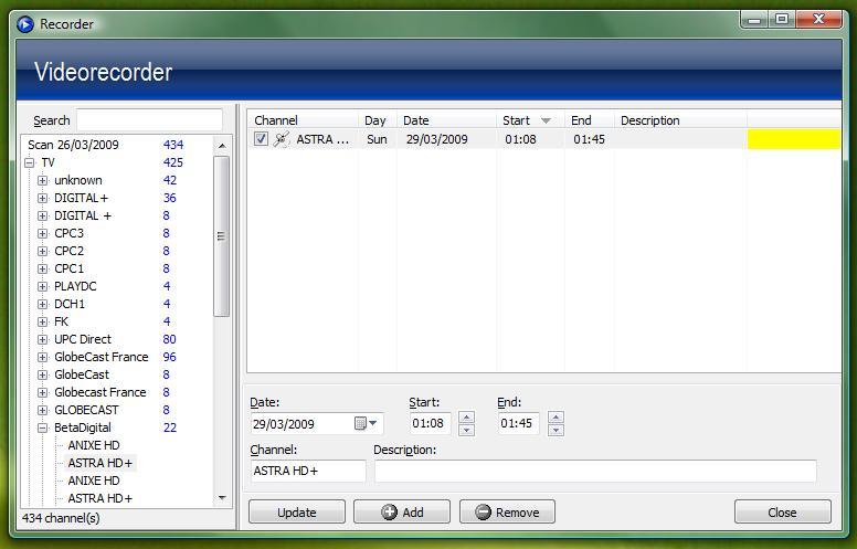

Your DVB app should let you delete these.
Hard to say, there may be more than one.
You should have one on the cd that came with your card, and usually can find one on the manufacturers website too.
For HD? Yes it isl
Not familiar with that DVB app, so can't say.
Sorry, don't see the error you mention.
These are probably scrambled channels.

Hi Trinity :) Thank you very much for your kind reply !
Here are the answers to my own questions I have found:
1) Apparently there's a difference between analog and digital.
A friend of mine told me that the old receiver where we received approx 30 free to view channels was still analog.
2) In the screenshot of the SCAN picture is a box saying "free to air only".
When ticking this box before making a scan, it will show unencrypted channels only.
3) This one is still a mystery to me. Hopping from one channel to another within that folder only shows the same program.

7) The error was "All capable DVD adapters are busy, No free device has been found".
That happened intermittent and since I unplugged the card, the very error message came up as well. Funny.
