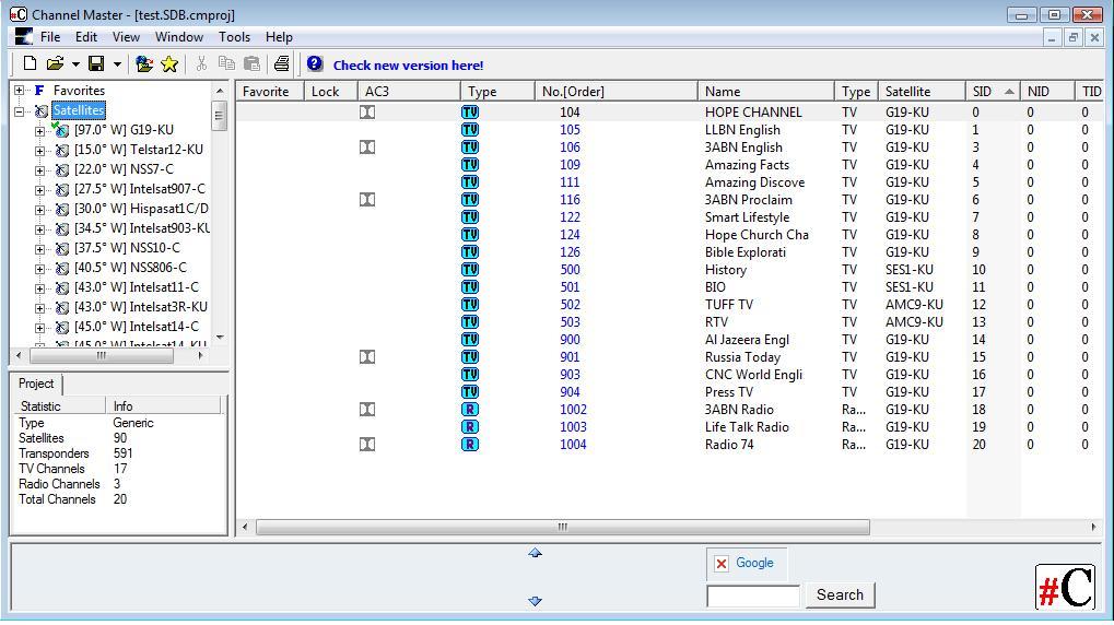

I am still having problems with the Channel order number-- I have enclosed a picture and the file, maybe you can see what I am doing wrong? In the Picture you can see what I am aiming for.
  • channels.zip
    channels.zip

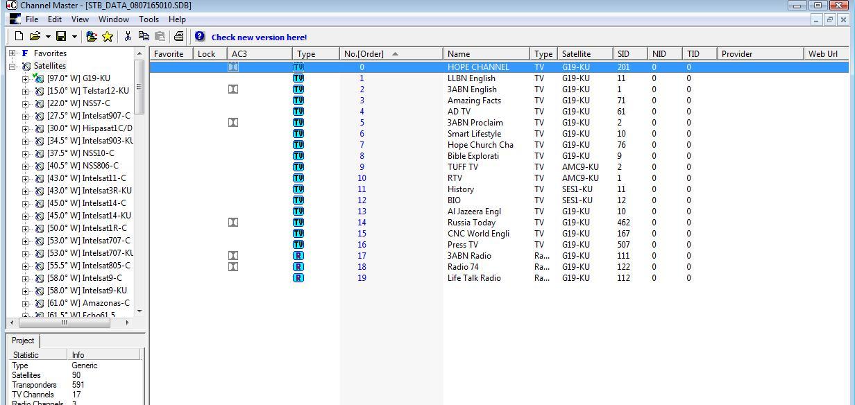

No.(order) needs to be 0, 1, 2, 3, 4, etc. Leave the SID as scanned. If you wish to display a different number in the front panel or on the channel banner, edit the channel information and place the channel number that you wish to display in the Teletext field (I.E. 901, etc.)
That helped a lot Brian. The channels are in order now but the channel number in the Teletext field is ignored by the STB for some reason and channel numbering starts at 100 and continues sequentially? Any ideas as to what I am doing wrong?
  • channels2.zip
    channels2.zip
Just an update--
When I load the channel list on the STB it loses the Teletext field input for some reason? Any ideas? This is driving me nuts:)
I will need to confirm. The Teletext field channel assignment may only apply to the STB when in the Glorystar mode and may not be an option in the Advanced mode.
