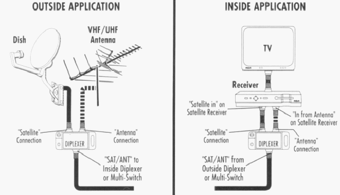

Dear people,
I have charter basic TV cable, a satellite dish, and coolsat 6000 premium receiver. What is the best way for me to be able to enjoy both worlds, cable tv and FTA with minimum effort on switching coaxes or button presses on the receiver? I would like to be able to split these capability to multiple rooms as well.
I got :
- Coolsat 4x1 LNB switch,
- separator switch that has INPUT, SATELLITE1, and SATELLITE2 ports.
- DPD2 switch that has IN/OUT, VHF/UHF, and SAT ports
- regular splitters
any information leading to enlighten of this newbie will be greatly appreciated.
thank you in advance.
Hi!,
Sounds like you have everything that you need. This should not be too difficult. You will need a total of 2 DPD2 Diplexers.
OUTSIDE:
1. Go outside and find the location where your cable feed is coming to the home. There should be a splitter there where it is feeding all of your rooms in the home.
2.. Take your DPD2 "diplexer" and put your satellite dish feed into port "SAT".
3. Make a small jumper and run one end to the VHF/UHF port on the DPD2 Diplexer and the other to your cable splitters "out" port.
4. Find the cable line that is going into your home and put that in the DPD2 Diplexer "IN" port.
5. Go back into your home and make sure you are still getting your cable TV. If so, Then everything so far is correct.
INSIDE:
1. Make 2 small cable jumpers (around 12" is fine)
2. The cable line that is coming in run it into the "IN" port on your DPD2 Diplexer.
3. DPD2 Diplexer - Run a jumper from the UHF/VHF port to your cable STB or if you do not have cable STB, Run it straight into your TV.
4. DPD2 Diplexer - Run a jumper from the SAT port to your coolsat 6000 satellite in.
Now you should have both Satellite TV and Cable TV on one cable line.
Now hook up your Cable box and your satellite box to your TV using RCA, composite or component cables wich ever you choose. Then using your TV remote, You can toggle from input 1, input 2, Component 1, component 2, TV, Video 1, Video 2 or how ever you have connected your STB.
See attachment: The Antenna pictured will be your Charter feed.
NOTE: Picture shows your cable feed (INDOORS) going into your satellite receiver, You may install it this way but if you have a Charter STB, connect the UHF/VHF feed directly into your Charter STB.
