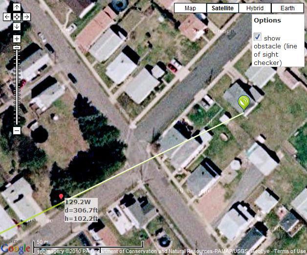

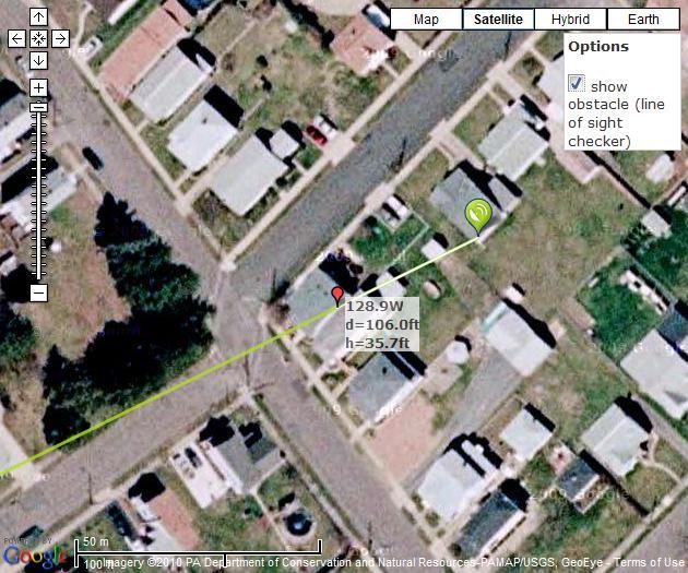

Here's what dishpointer.com gave me:
Satellite: 129.0W Ciel 2 | Galaxy 27
Elevation: 18.6°
Azimuth (true): 243.7°
Azimuth (magn.): 255.9°
The problem is that it's a $95 charge for a technician to come out and try it. I don't have any positioning equipment or else I'd probably give it a try myself. (I'm a software developer and electronics-nut but I've never messed around with the dish placements or tuning, etc).
Is there a "simple" way I can see if I can get it before having a technician come out?
EDIT: I've uploaded a JPEG of the dishpointer.com google maps view. I've placed the height marker on my neighbor's house. You'll also be able to see some trees just grazing the line-of-sight.

By all means try it, But 18 Degrees make Line of sight an issue around these parts. If he lives in a wide open field over looking a vally, most lilky he'll get it. But anyone that lives in Northeaster Pa, knows this is not common.
Better mount it on the peak of your roof.
