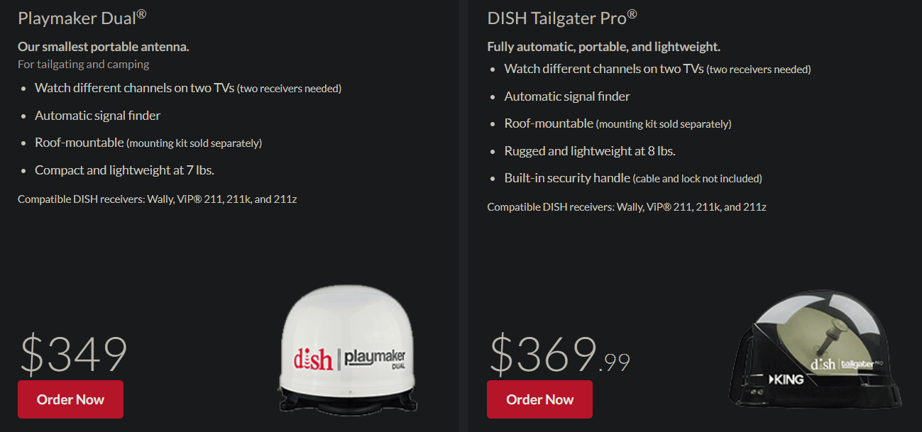

How about the case of using an auto-aligning Playmaker Dual or Tailgater Pro, or others with dual outputs, then using this type of dish with two Wallys...either feed two different TVs OR feed the outputs of two Wallys to two different HDMI inputs on one TV, thus allowing multiple tuners. According to the descriptions of those dishes, each receiver could be tuned to (and record) different channels.
Yeah, probably should of been a little more specific and say that multi tuner functionality in a single box was not possible.
Sort of, but not really. These auto aligning dishes only have one LNB inside them, so you end up with a master-slave system where the main receiver has control of which satellite said LNB should be looking at, while the second receiver just has to use the only thing it can get, which is the same satellite currently in use by the primary. So if you want to record a show from the same satellite the primary is recoding/watching then you are fine, but as soon as the primary switches satellite you get signal loss and a interrupted recoding on the secondary. So it does sort of work but you would have to have something like this webpage for guidance or a general idea of where your channels are located.
Excellent description. The Marketing department should somehow include that to expound upon "Watch different channels on two TVs."
