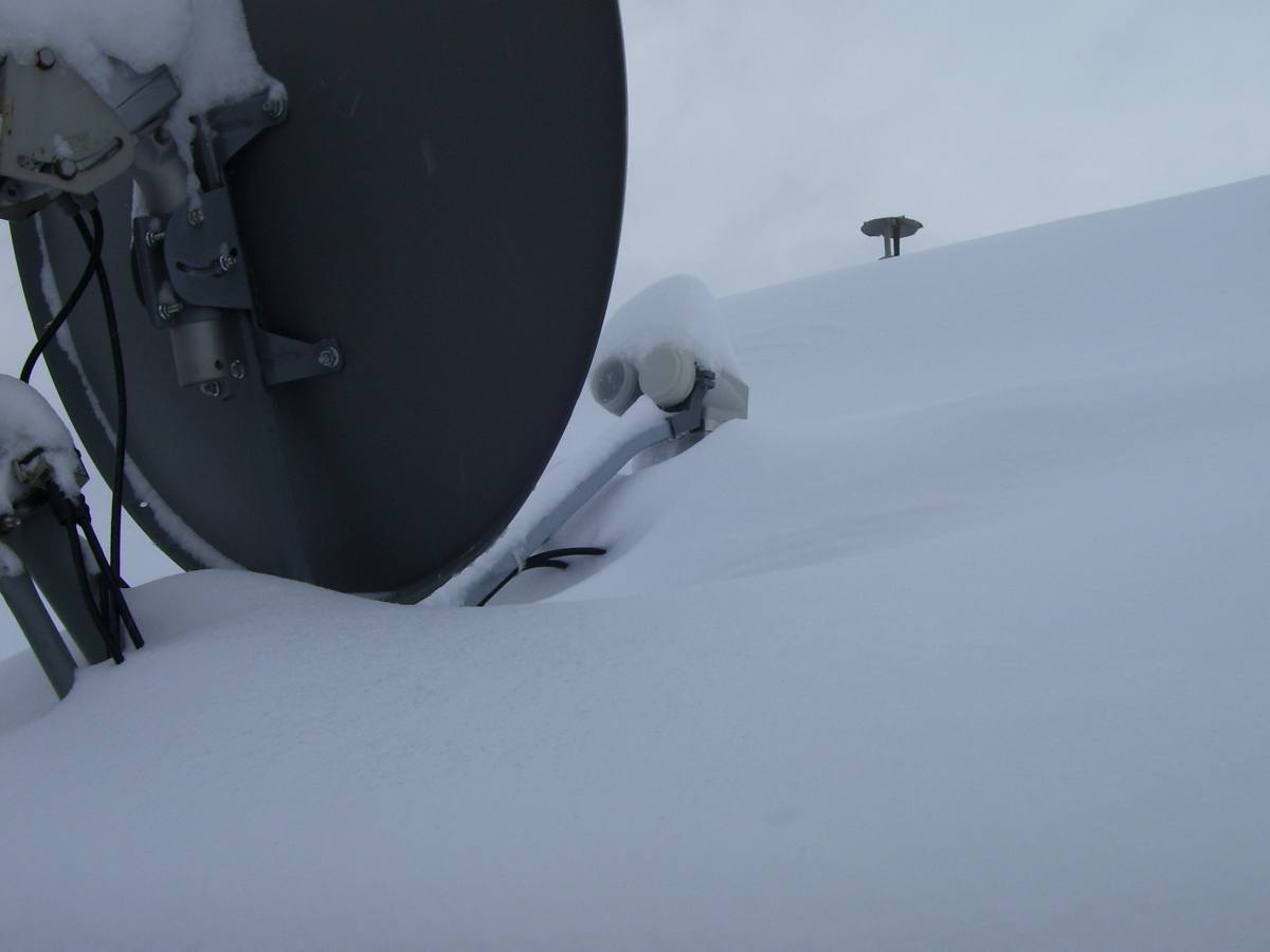

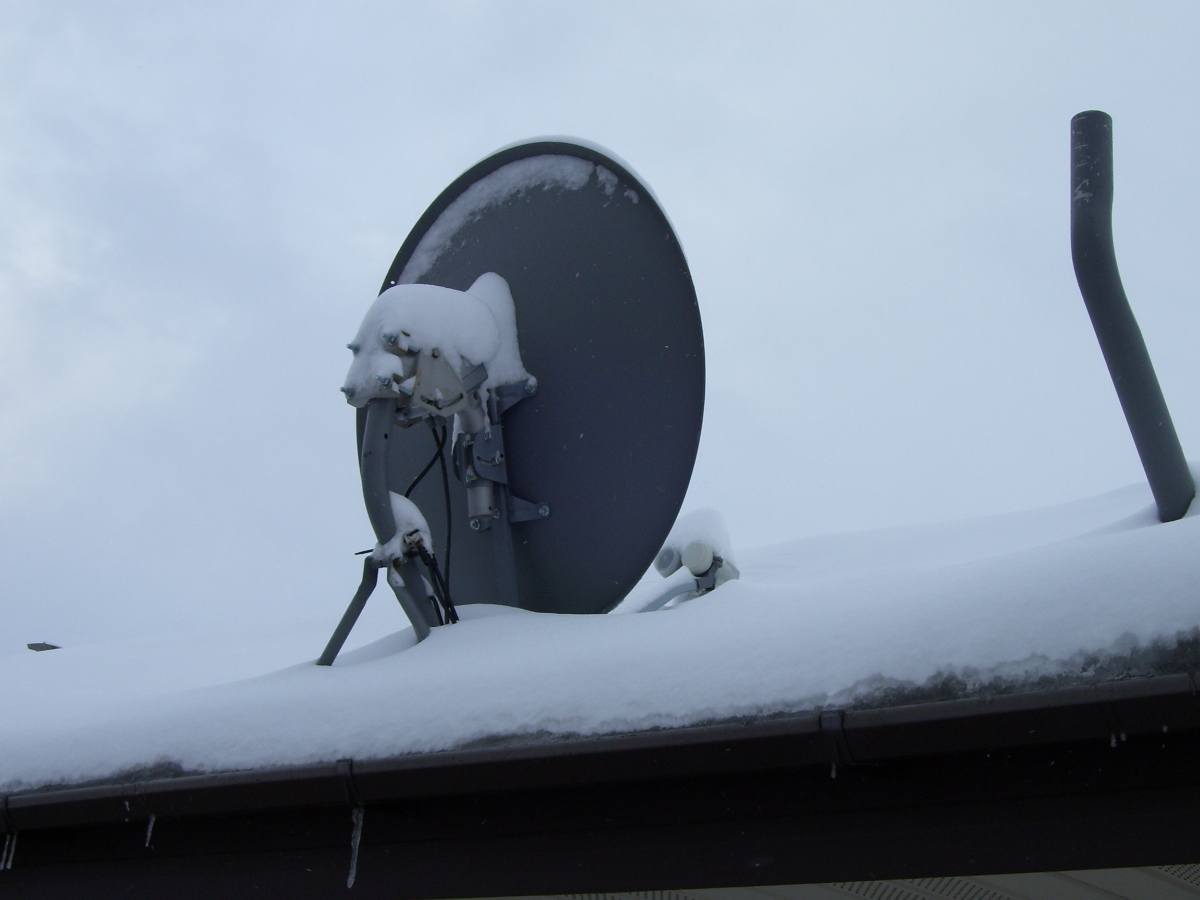

In the 9 years I've had FTA I dont use anything. I just put the dish on true south and let the sun melt any of the snow. Also due to my setup the dish is pretty low on the roof so if we get 3-4 inches of snow I have to snow rake around them anyways so I just clean the dishes off then :)
I mean when you have something like this after a snowstorm.....nothing will help ;)

Snow or ice build-up on a small KU band reflector has minimal effect on the signal. Snow or ice on the LNBF face or build-up on the arm in front of the LNBF is a major problem. Here in the Sierras they often use Rain Shield on the LNBF face and a fabricated triangle on the arm and coat it with Rain Shield or wrap the arm with heat tape. If build-up on the reflector is an issue, heat tape or a heater strip designed for satellite dishes is applied to the reflector. I have only observed the reflector heating in commercial installations or in extreme situations where the prevailing wind will drift snow to envelope the dish and build out to the LNBF.
If aesthetics are not an issue, consider using a large poly garbage bag over the entire dish and arm. The thin plastic will flex in the slightest breeze and shed any accumulation. I once saw a very innovative solution with a small automotive 12vdc fan/heater clipped to the LNBF arm keeping the poly bagged dish warm and cozy..... Wouldn't have done that myself, but I thought it was very creative "out of the box" thinking!
