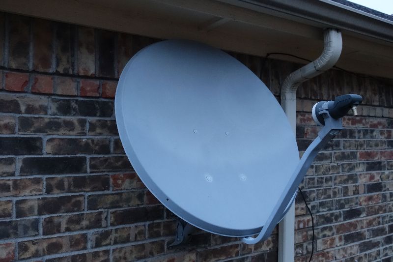

is this dish about a 30 inch dish ?

Looks to be. Would work better if it wasn't shaded by the overhang. Gotta be knocking out half the signal.
I've 'fixed' a few D15H and direcked 'self installs' by moving the dish down a couple of feet.
found the dish on craiglist for reasonable offer and was looking for a ku dish instead of going c/ku on my 7.5 foot dish just want to verify the size before making an offer
I got Channel Master 1.2 meters for" 1) free and 2) $25. (to buy some ply and paint, to make a sign, which was the 'plan' for it) All the 30 inch CM's were free. I'd offer 20, only because there's a usable FTA LNBF by the looks of it. Maybe it's a 33 inch ??????

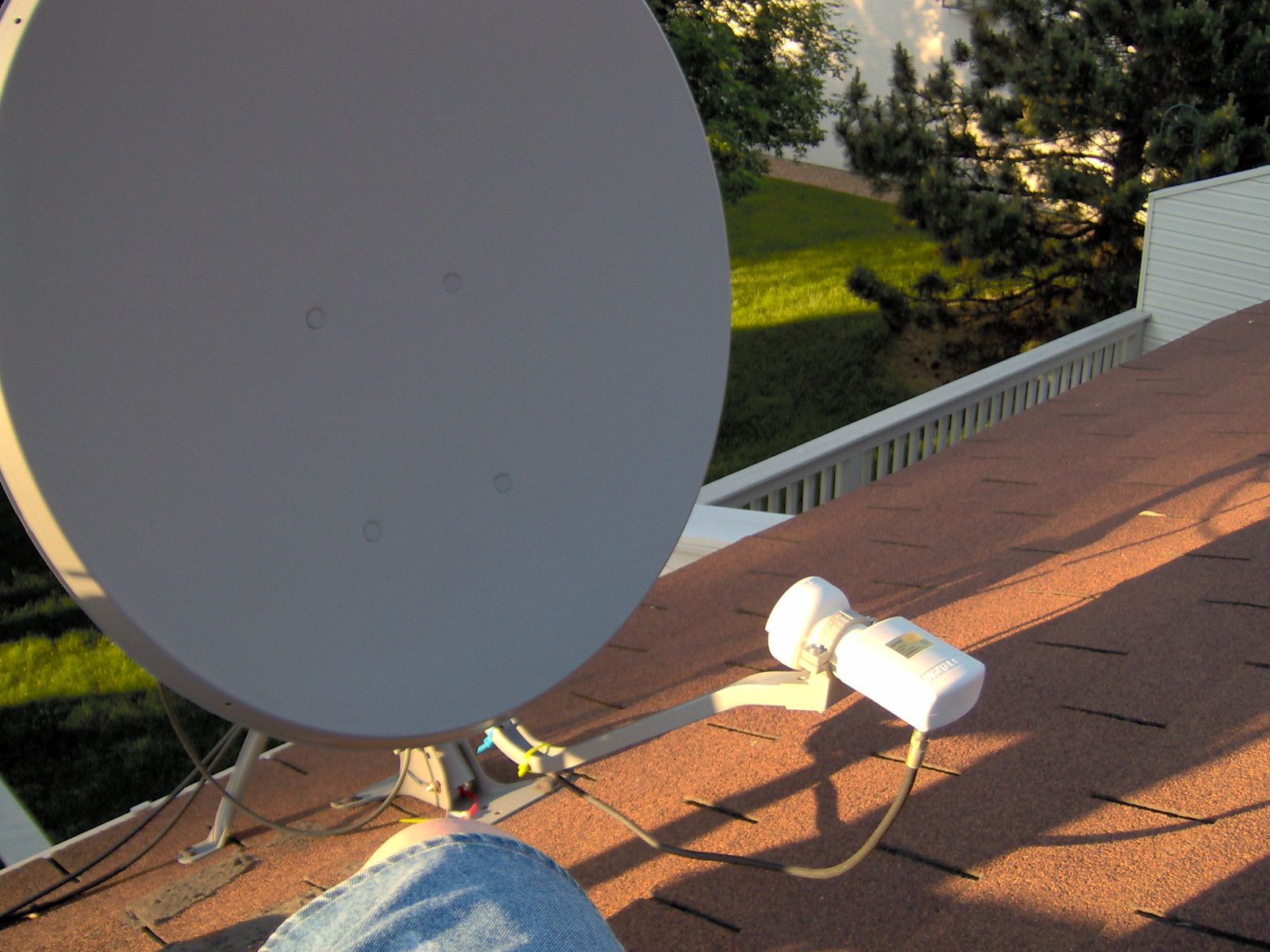

Its a Winegard dish. I had the same one. Looks to be a 30" dish
I agree, 30" Winegard. It's too small for good Ku coverage. 1m minimum recommended for a motorized installation.
I used that 30" dish in Minnesota with no issues. The only satellite I had issues with was 116.8 and that was more due to footprint and 103W but that was due to the wonky skew

The Winegard is a good dish and I used one for many years :) For a 30" dish you can't find a better one. It just wasn't as good as a larger dish for those hard to lock football feeds. I think there might be issues on 125.0W with the smaller Winegard. But since I have 10' perforated dishes with C/Ku feeds, I haven't used the Winegard in a couple of years.
