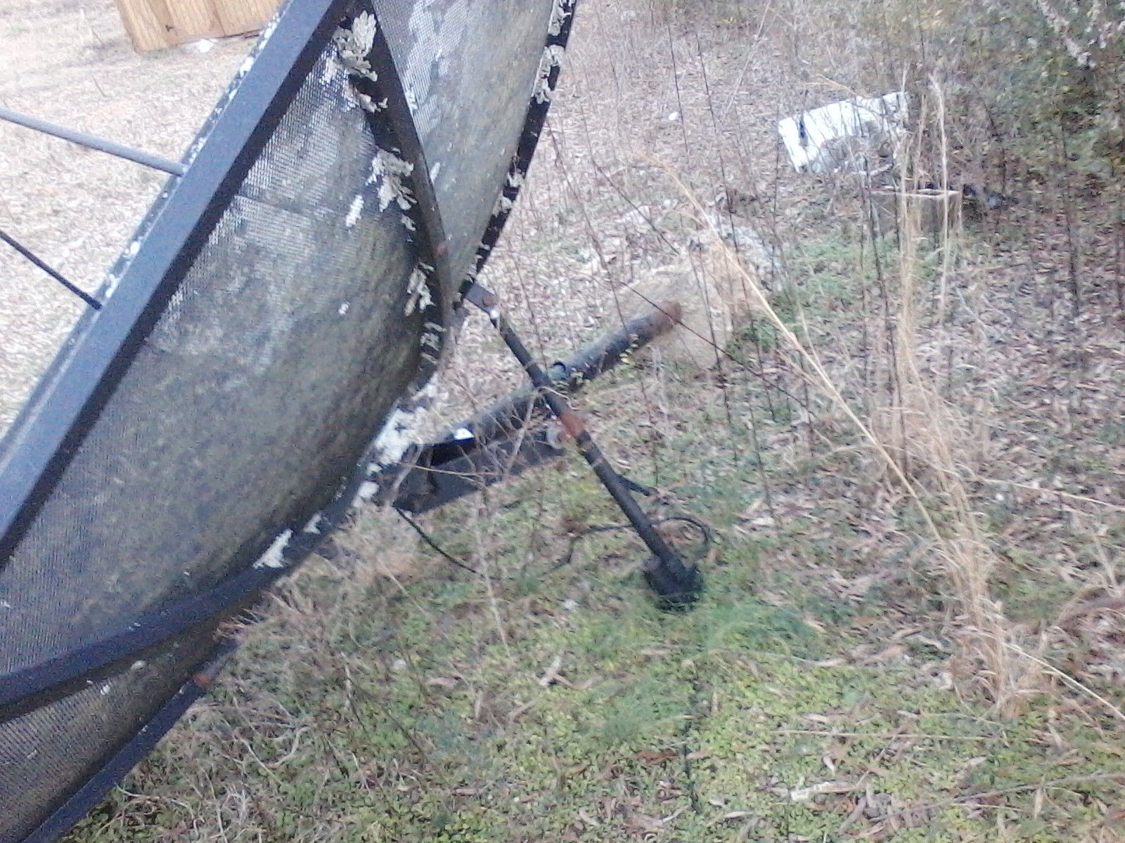

Here is a photo of the mount still on the pole, I guess it's impossible to tell the size from this?

Every dish i have found here in south carolina. All have been 3.5 inch. I found two 7.5 and two 10 foots.

Take the existing pipe/pole when you get the dish. So close to Done.
Yea, you're right, I will take a sledge hammer with me and break off the cement, and the pipe comes home with the dish. Great idea you shared.
