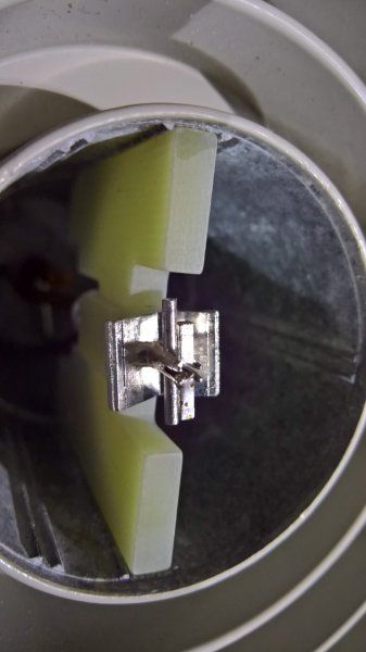

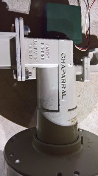

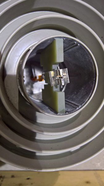

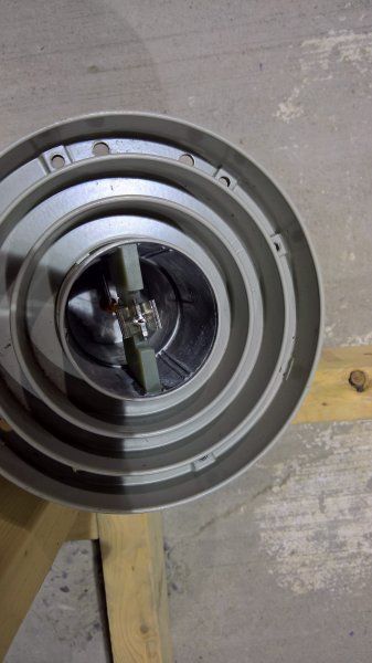

Hello guys , i need help here, how can i differentiate co-rotor II plus wide band and a co-rotor II plus, i just purchased on eBay a feed horn , the one i received has a patent N# 4414516 and no part no# . my intention was to have a wide band feed horn that can be used in Kenya. see the Photos bellow and advice me

I'm not a real expert on those wide-band feeds. But it seems to me the big difference was the wide-band model was set up for circular polarized C-Band signals like the one you pictured. Ku is Linear. I see the Dielectric slab in the feed for circular signals on C-Band. That doesn't affect Ku band. But you cannot receive linear C-Band with that feed. There are examples of feeds extremely modified to do both circular and linear signals by some of the members here.

The frequency range will depend on what LNBs you put on the feed-horn. The polarity of the signals you want will determine if this feed will work. Like I said previously the feed you have will work for CIRCULAR ( Left & Right) c-band polarity but not LINEAR ( Vertical & Horizontal)polarity signals in the 3.4 to 4.2 frequency range.

Looking at the photos you have the Co-Rotor II plus wide band.
You will be able to receive Satellites that broadcast there signal on circular and linear polarity
