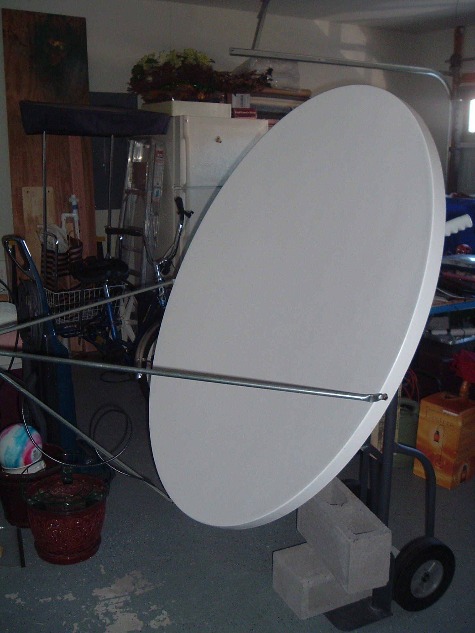

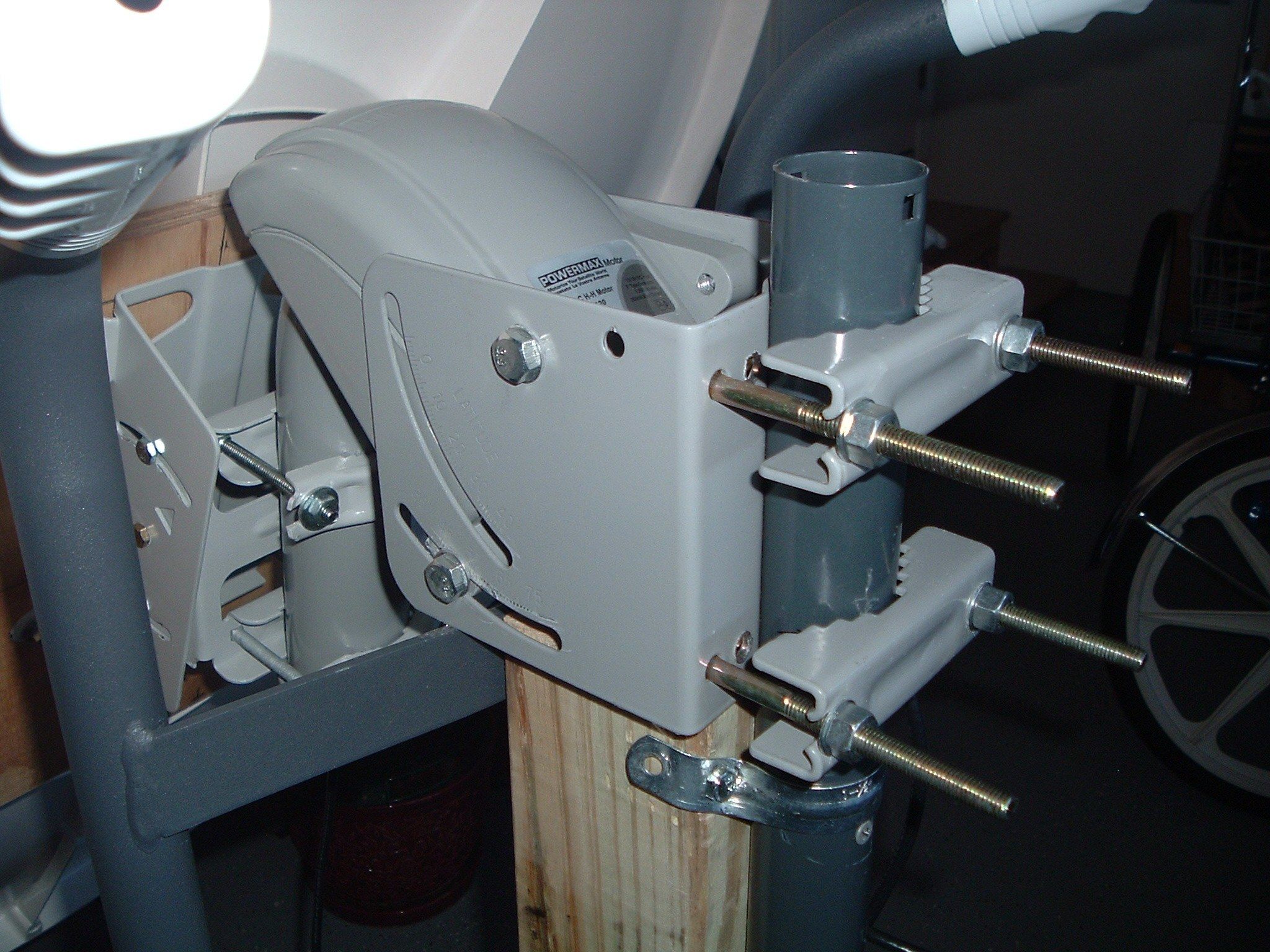

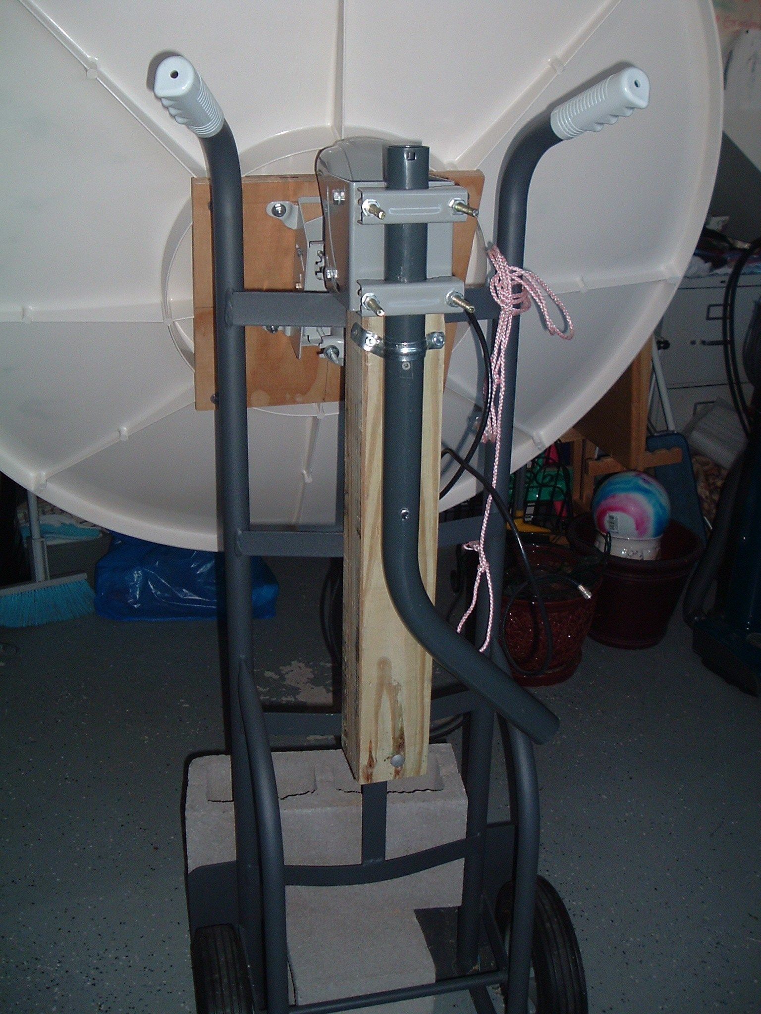

MY SPRING PROJECT
This spring project is making my Prodlin 4 footer more solid on my hand truck. I had mounted the 4 foot dish on a hand truck so that I can move it in and out of the garage easier. (I live in an HOA complex)
The first try at it I had the post mounted in the front of the hand truck. The weight distribution was all in the front and the dish had a tendency to tilt forward. I move the post in the back of the hand truck and moved more weight to the rear making the weight distribution better. I needed to move the motor even back further and I had mounted the motor on an old J-mast and now my problem is torsion twist.
When you rock the dish sideways, (simulating windy conditions) the motor bracket, the mast, the post and the hand truck, twist and distort. I need to beef up the metal on the hand truck and eliminate the post.
I was leaning toward making a mast out of water pipe and have it shaped so that it would attach to the back of the hand truck and with elbows extend the mast at the back enough that the weight will be distributed better and hopefully I can eliminate the distortion when the dish is twisted sideways.
Any suggestions will be greatly appreciated
