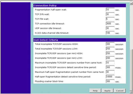

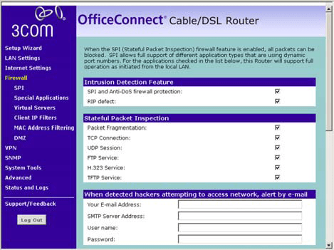

I cannot access SatGuys at all with SPI turned on in my router firewall and here is what comes back to me from the firewall email alert:
Dear User
Your router has detected and protected you against an attempt to gain access to your network. This may have been an attempted hacker intrusion, or perhaps just your Internet Service Provider doing routine network maintenance.
Most of these network probes are nothing to be worried about - these types of random probes should NOT be reported, but you may want to report repeated intrusions attempts. Save this email for comparison with future alert messages.
Your router Alert Information
Time: 01/29/2008, 21:19:24
Message: TCP FIN Scan
Source: 65.99.220.89, 80
Destination:71.114.98.177, 2775 (from WAN Inbound)
Time: 01/29/2008, 21:19:39
Source: 192.168.4.100, 2750
Destination:65.99.220.85, 80 (from WAN Outbound)

I'm logged in. I'm sure there is some discrepancy between how my SPI/anti-DOS is setup and how the server is responding to requests.
I'm sure I just need to change some default values in order to give the server the time to do it's thing.
are those the default settings? Also, do you have the latest firmware on the router?

Those are the default settings and I have the latest firmware loaded.
Yeah, it is very strange. No other site does it either so it's not like the settings are too rigid.
I remember dealing with something like this with a 3com product a couple years ago. Their SPI is sensitive to the number of connectoins being created and used. Also, 3com supoosedly fixed how their units stacked/stored/unstacked the connections and how the SPI handled em, but regardless of what they did in the firmware, there were always some sites that tripped it up.
There was no magic setting to change either, it was hit or miss and very annoying. In older versions there was a hidden page for SPI settings, but I cannot remember how to get into it.

I changed the TCP FIN WAIT from 5 seconds, the default setting, to 30 seconds and everything is fine.
Thanks guys!
