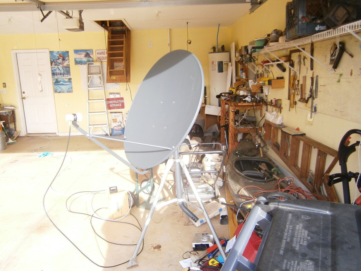

geosat 36 inch dish
geosat sl1pll
gtmedia v7s2x
sat finder-lights show 22khz and 13v
install menu i setup
lnb freq universal 9750-10750
disc 1-1.1 disabled
22k auto [greyed out]
lnb power auto
galaxy 19 is 47 elev and 204 az for me

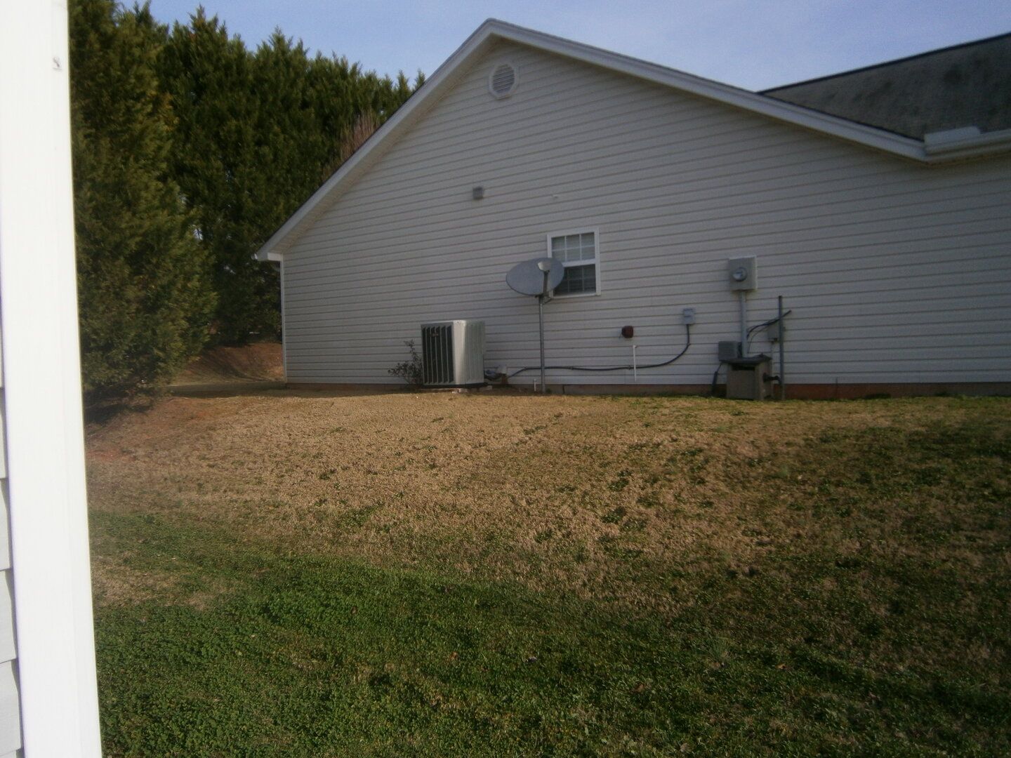

pics of my sat and the neighbors. i think i have my elevation way too low?
did i screw up on the elevation collar thing with the 'a' 'b' 'c' slots to pick my elevation range?

Make sure you have a good, known, active, transponder programmed in. While you are trying to aim your dish. 12152 H 20000 is a great one for Galaxy 19.

Here, go for 97w, it's by far the easiest one to get. Heck, I could probably hit it with a rock IF I could snap my arm that hard. DishPointer - Align your satellite dish
Get the exact coordinates of your house from Google Maps, and put them in Dishpointer. It'll bring up your property. Then, zoom in EXACTLY on your dish location, and use the satellite drop-down list to get the exact bearings at THAT site. Pay attention to what the aiming line is dissecting through on your property. Aim the dish THERE!

You can blind scan any sat you want, HOWEVER, IF you really aren't aimed at the satellite, how would you expect to pick up a signal? These aren't tv antennas like on your house. Think of a KU beam being the width of a PENCIL!
Yep, it's THAT CRITICAL for aiming!
yup, i've discovered already when they saw have the dish plumb they mean it. it can't be waved around like a big old tv antennae.
ok, i'll try again. the 2 signal spikes i hit were pretty much 90 degrees east of me and much furthur east and lower in the sky than the neighborsdishes around me that are dtv and dish
i looked up that site and that is exactly where i am pointing the dish to look for the dish. i getting signals that are pretty much 90 degrees of where galaxy 19 is. are there sats 90 degress east of g19? can cell towers screw things? i have very nearby cell towers. and a airport is right where g19 is.
you can select whatever satellite you want in the menus in your receiver, but you'll receive only whatever satellite the dish is aiming at. In other words, the satellite list in the receiver is only there to keep things organized once the dish is properly aimed at the various satellites.
Now, to get you started, there are 2 ways you can proceed:
1- enter a known transponder with correct parameters, I'd suggest the one with CGTN on 95W, as it's probably the easiest thing to receive. Make sure you have the LNBF setting set to 10750. Thenn set the elevation correctly for your location, and move the dish slowly on it's mount until the meter in the receiver shows signal quality. If nothing found, change the elevation by a half degree and tray again. Repeat until you find signal quality. Then do a manual transponder scan and you should have a bunch of chinese channels in various languages.

  • Is your dish mounted (or tripod) on a flat surface for sure? If not, those numbers on the back for elevation will be wrong. Use a level and make sure it's perfectly level and vertical.

I used a couple of different apps on my phone to help me point. They're a compass/satellite finder all in 1. I also found that the direction they provided was very unpredictable, and I had to keep holding my phone up in the air and waving it around in circles to get it to 'sync' back up again. I also noticed I couldn't be too close to my dish when I used it, because the metal in the dish (or something about the dish) would throw the compass way off. I had to stand about 5' away from my dish to use the compass/app. It was a challenge, and it only got me in the ballpark of where the satellite was. If you are 100% sure the elevation is correct. you just need to slowly (1/8" at a time) move your dish and watch for signal. Wait a second, move it again. etc. back and forth.
