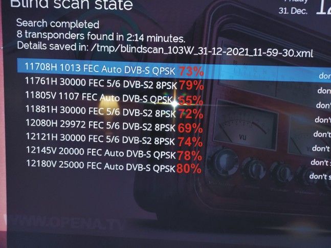

Also look at my latest 103W blindscan. See anything strange? Frequencies and signal rates are a little off.
The nature of the beast. LNBF or receiver frequency off a little bit? Who knows.
But anyway. Heres a scan from a little while ago with a signal strength over lay.
