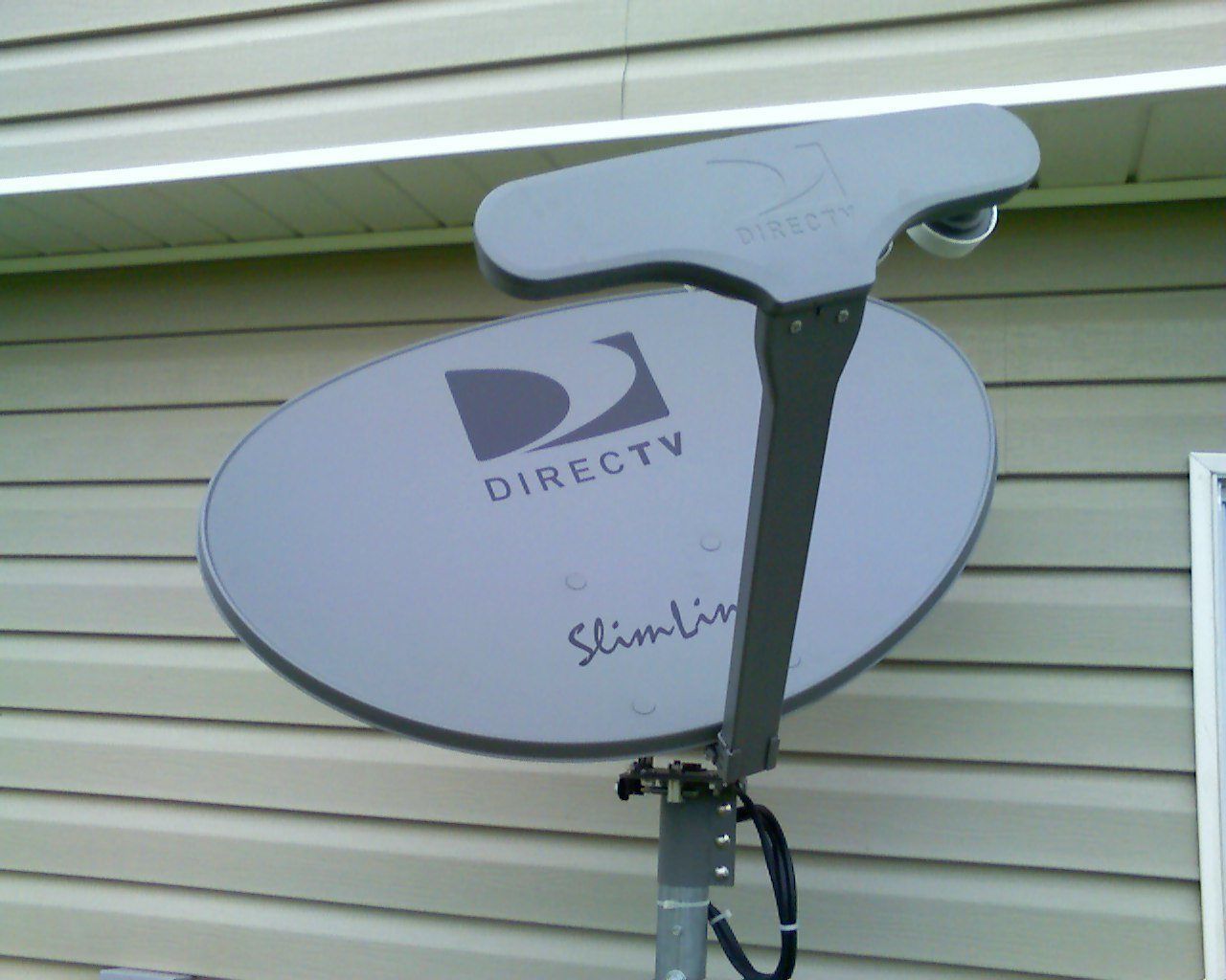

I opted for the 2" exhaust pipe as I stated above so I did not have to wait on the shipment and could keep my pole that was already cemented.
I used a hammer and slightly dented the top and bottom edges of the pipe so it would slide over the pole and stay in place by making a semi tight fit. I then drilled two holes and ran hardware thru it. Its sturdy as hell.
Ill see if I can find the pictures on here.
Here's the pic of mine. You cant tell its a pipe slipped on, but if you look near the bottom of the dish bracket youll see a self tapper I put in to hold it in place, then you'll see one of the two bolts I added.
This has been very sturdy so far.

That was what was recommended to me because I had a pole with an of of around 1.8".
I hope it holds up for you, muffler pipe is normally fairly thin walled. No where's near schedule 40
