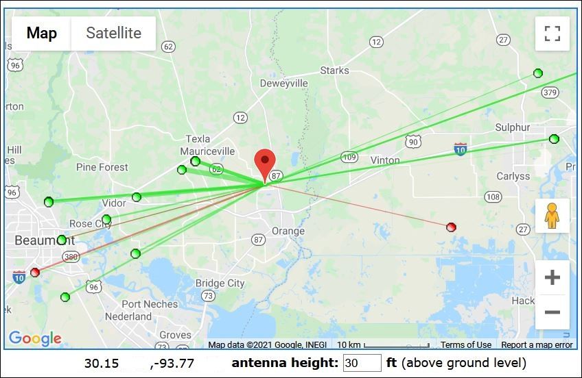

Your rabbitears.info signal report:
RabbitEars.Info

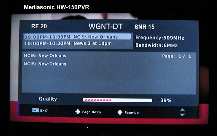

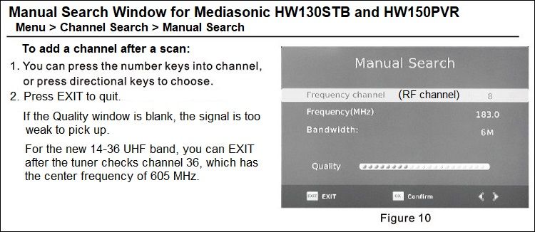

I suggest you try the Mediasonic HW-150. It has a tuner that is at least as sensitive as my SONY TV and is able to add a channel after scan.

It also has a signal quality scale (SNR/MER) that shows the Digital Cliff (SNR 15 dB) at 39-40% which is helpful with antenna experiments.

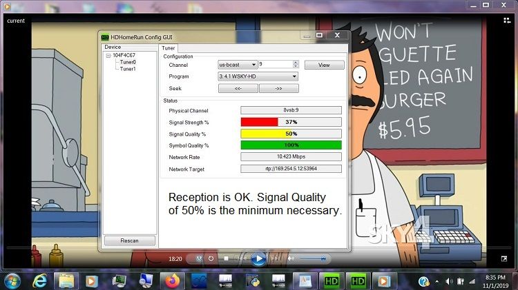

The DVR feature on the inexpensive converter boxes isn't that great, but the tuner is sensitive and the 39-40% Signal Quality point is similar to the 50% Signal Quality point on the SiliconDust HDHR GUI:
