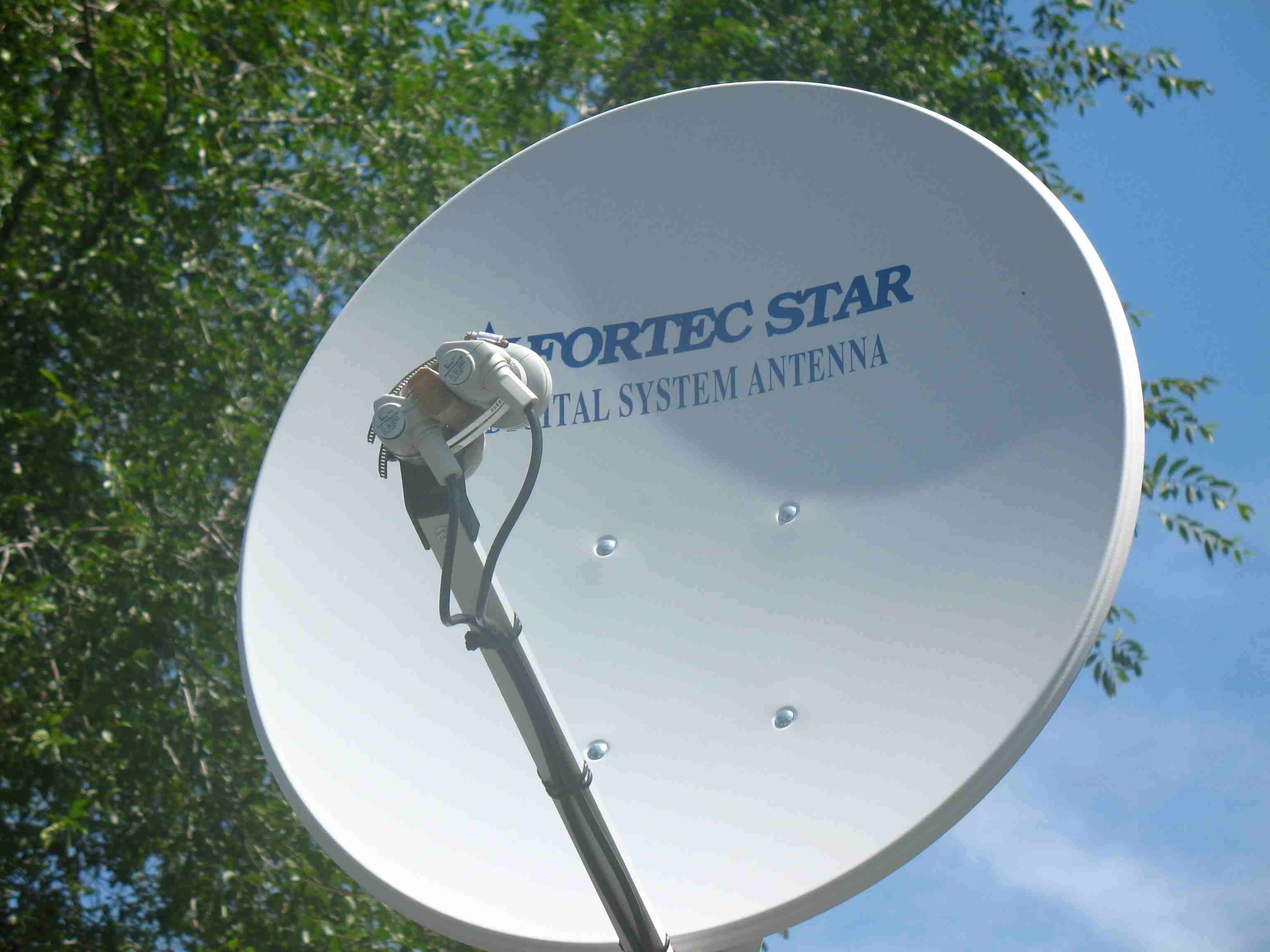

Here is a pic of 2 fta lnbs. Same principal.
Nice mounting system there!! Found my dtv lnb, gonna wait a bit to go up and try it out. It's only 101 today!! Thanks for all the information. I have found more stuff than I think I can ever watch.

Thanks! That is for G10/IA7. I had to use 2 straps due to the roundness of the lnbs. But zipties/hose clamps, etc work gret. 101? Geesh! I hope you are not west of here, I am tired of the heat :-)

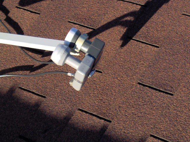

Good luck on your project! I was feeding my extra outputs on my Dish 500 to the FTA for audio, but now I have other switches and lnbs taking up those slots :-)
Here is how I had a DBS/KU setup a while back
(DBS on left, KU on right)

Is it my imagination or are both lnbs aimed off center from the lnb mount arm in that photo? Maybe, it's because the photo is taken from the left side, but, it looks like they are both twisted off center towards the right. By the way, that DBS lnb looks just like the one off of the old dtv dish I have. What setting did you use with it? ( L O)

Iceburg, thanks so much for your help. I finally got it up and going. Only problem I had (and should have thought of) is with the dvb lnb being off center, and using USALS to locate the sat, it was not there. I finally had to go into Desq 1.2 and manually move the dish a bit furter east and there it was!! I tried storing it and then switching to USALS again and it would move it back to the original position!! Got kind of frustrating for a while. So, I left it on Desq 1.2 (after going back and resetting it) and now it seems to be fine. I guess it's ok to have a mix of USALS settings and Desq1.2 ? I also went to the other sat and got NASA and Angel and had to do the same thing there.
whoops. Forgot about that. With USALS what you can do is put in USALS where the DBS LNB should be. In my picture above, it was -5 (so if I wanted 91, I said 86)
That usually fixes the problem and can be fine tuned for best picture
