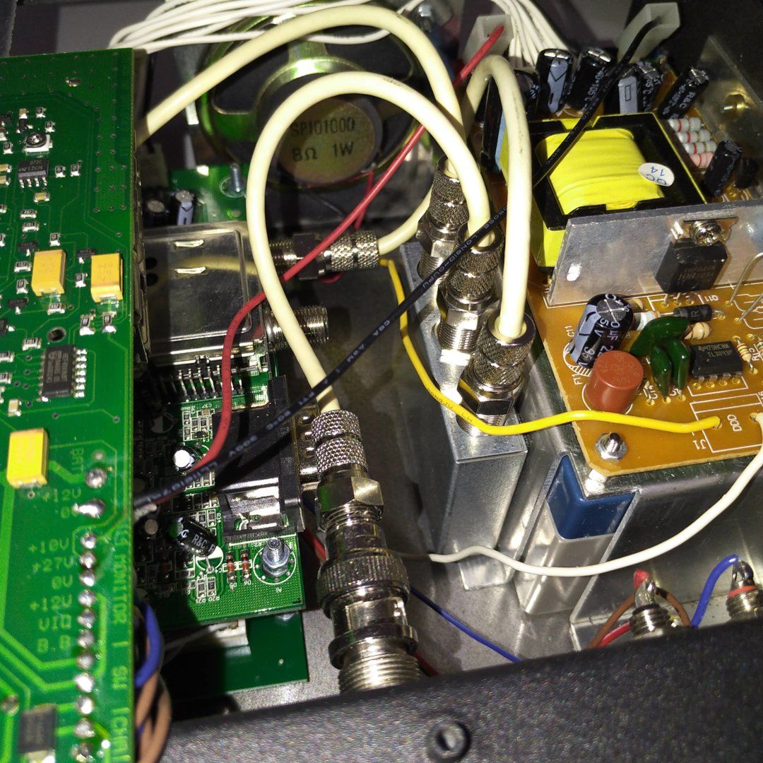

Good news after opening the lid today on the satlook and checking the main f bulkhead connector I found that the cross whip was OC this was why No Power or signal was getting through to the meter . This maybe because a few months ago I changed out battery and this area is where the battery clamps are and cross over cables are so quick fix just cleaned up the connectors .
Excellent work figuring out the problem! Good luck on your project! :) :thumbup
