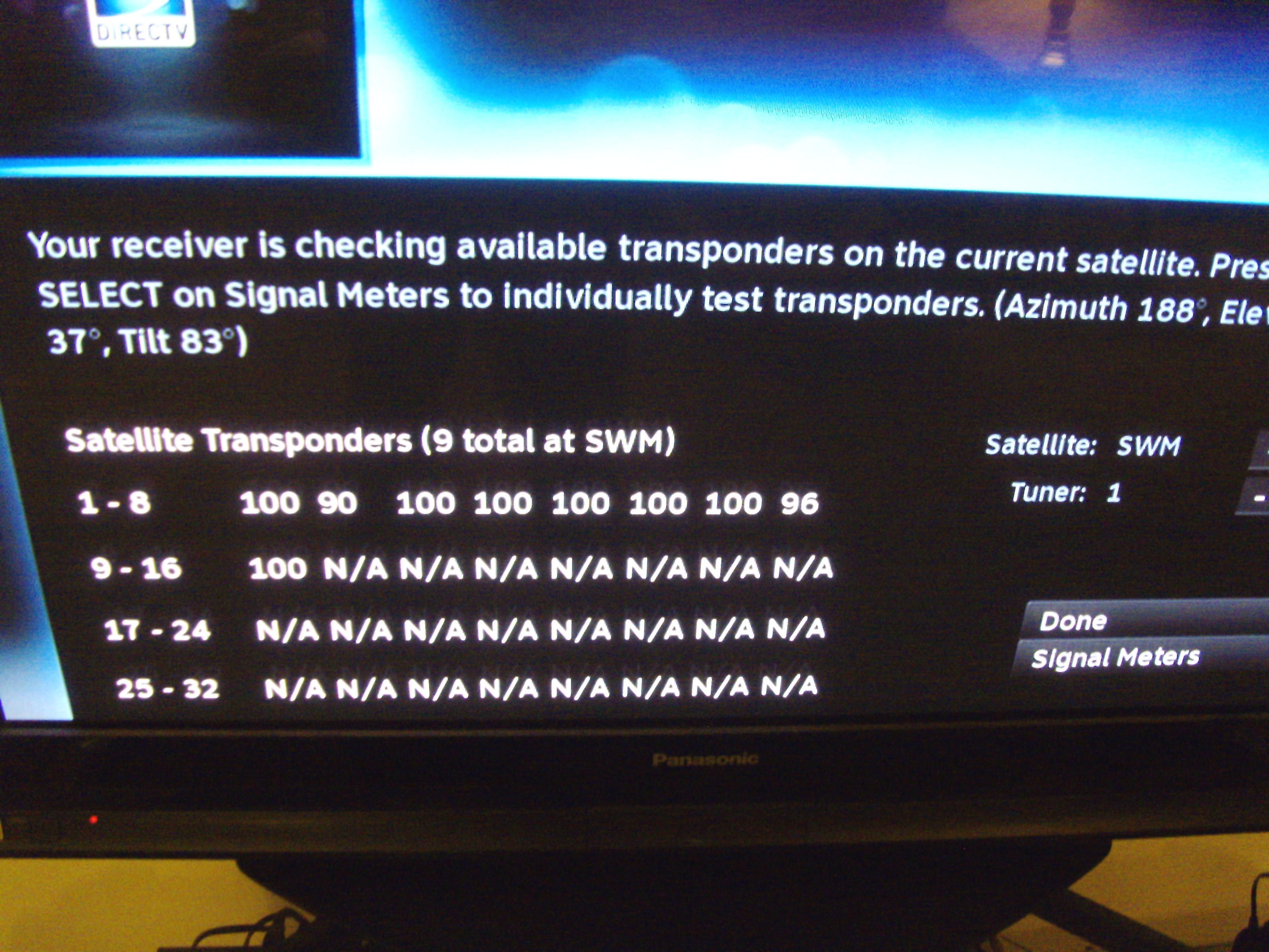

well a recording got over so I could check now
1-8 100 90 100 100 100 100 100 96
9 100
There's certainly nothing wrong with those signals.
My best guess is still an intermittent connector issue somewhere. Getting the wrong channel on an SWM system nearly always means something is interfering with the low-band control signal between the receiver and the SWM module. It could of course be a faulty SWM module....
What's between the HR34 and the SWM module? Just cable and connectors?

No, it does not seem to be that, that's why I asked for the SWM readings. If there were any other tuners on that SWM they would show up as zero signal in the test. Of course, it's always possible there is someone else with an HR34 which happened to be disconnected when iceberg ran the test but that's unlikely.

The point I made about the SWM signals is that if someone else was using the SWM you would see that with some zero signals on the SWM signal screen.
