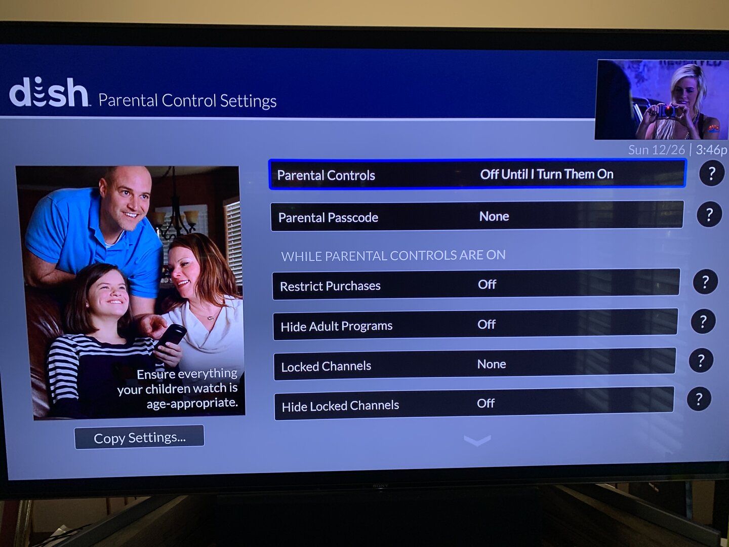

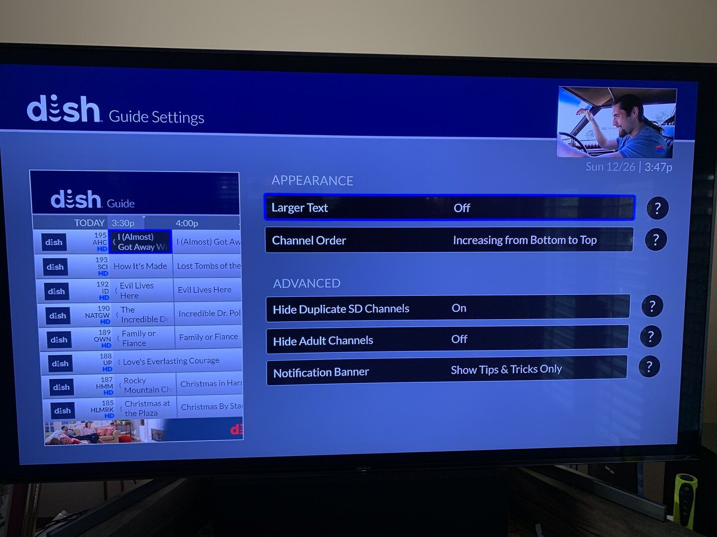

Thanks Navchop. I used a parental control on myself. checking Guide under settings showed adult channels were supposed to be hidden! Then , I went to parental control. It showed adult programming was not hidden! Contradictory. I switched it to 'off'. Now, the guide skips those naughty (:oops:) channels.
I am tempted to create a favorite list that will show channels I am interested in. I want to hide all those shopping and vod.

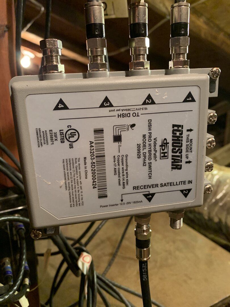

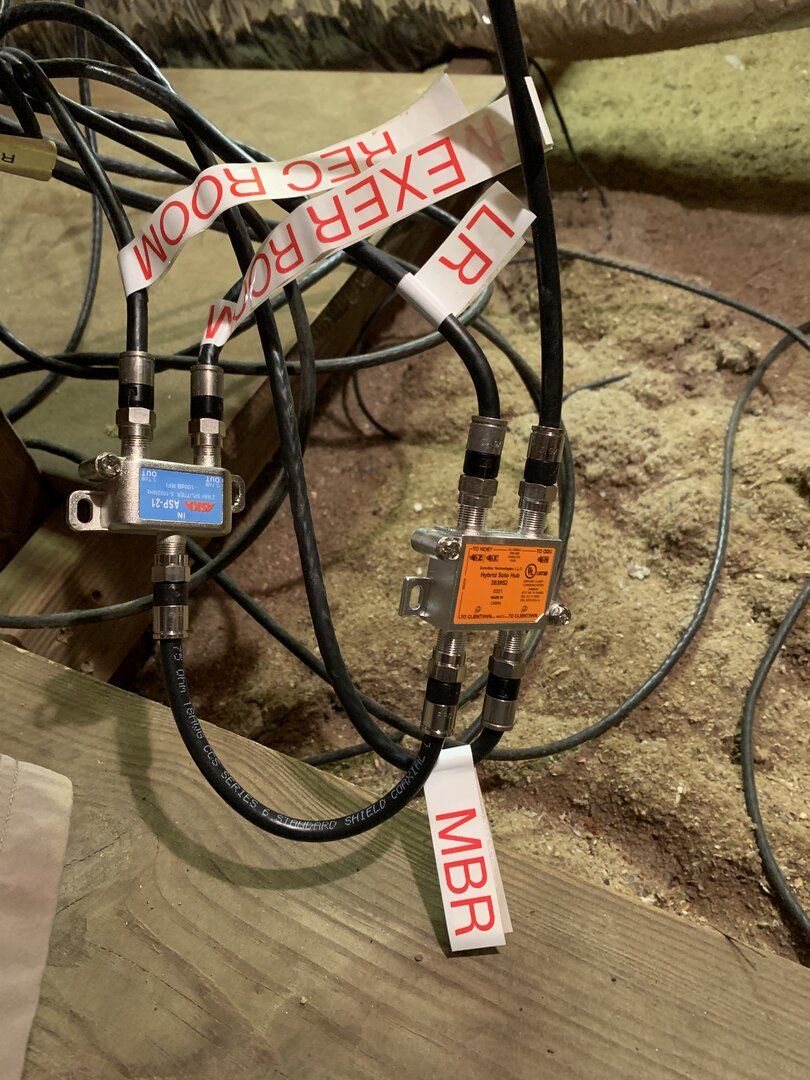

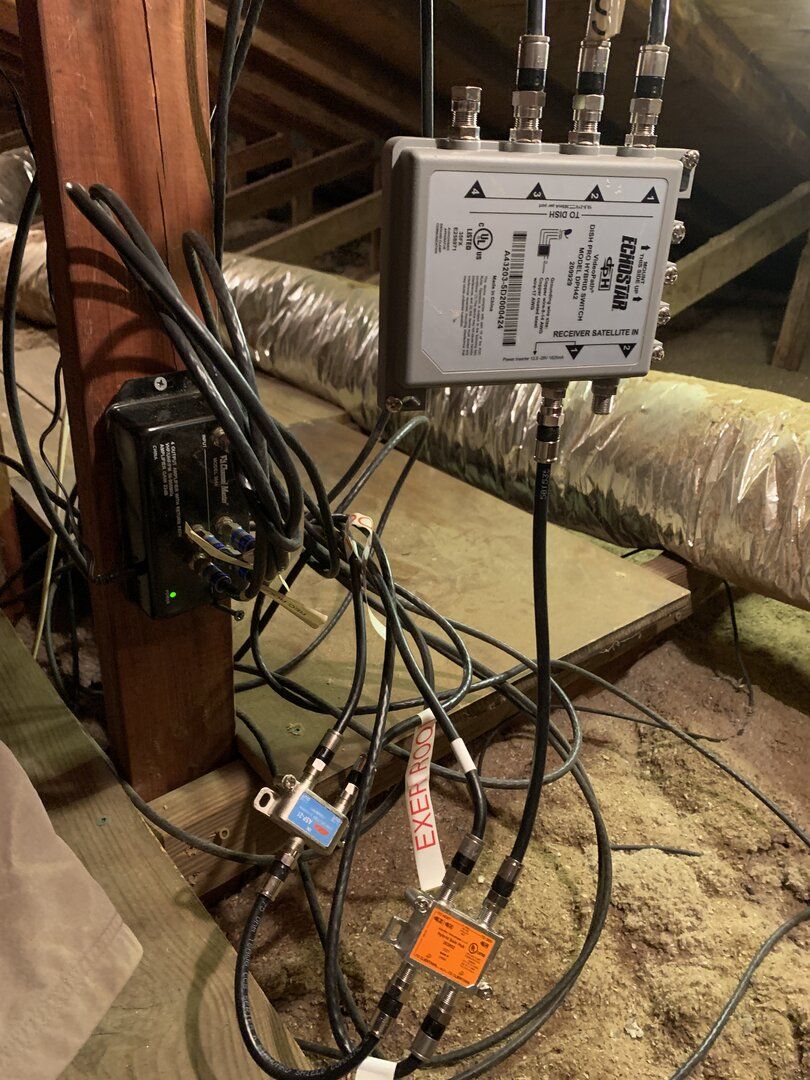

Well, look what I found. Note the Unterminated on the DPH42. The MBR lead goes to an unused and unterminated lead; same for the rec room. Exercise room has the J3 and the LR has the H3.
Sorry about the dupes.
I thought that was OK.
I don't know about what should or should not be hooked up to that orange thing (a hub?), but I think that's probably OK too. Where is the power inserter for that switch? And it appears to be dangling by the cables from the dish. I take a dim view of stressing those cables unnecessarily.

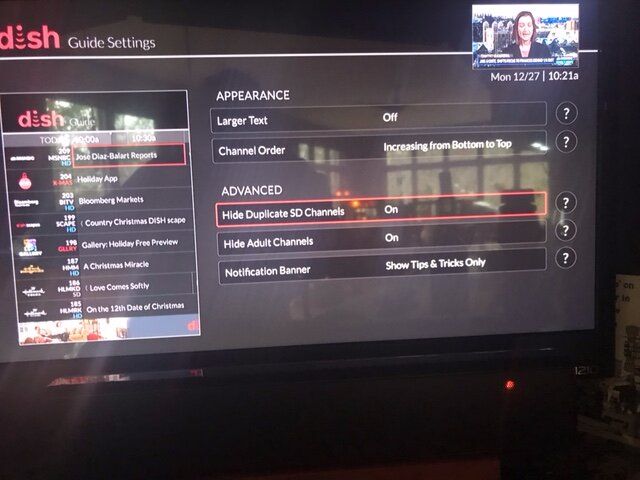

I do not subscribe to any of the porn channels. But on Sunday I was going through the guide on my Hopper Duo and a porn channel listing briefly appeared in the guide. It was probably there for 1/2 of a second and then it was gone.

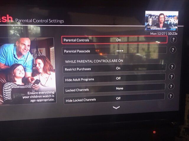

Very strange. In my Guide Settings, "Hide Adult Channels" is On. WTH?
