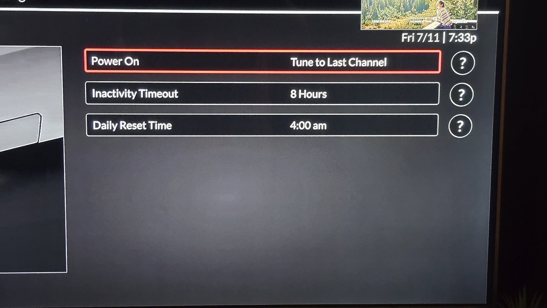

With your remote press Home twice, go to Power and bring up the Power Settings Screen. Take a picture of that screen and post it here.
