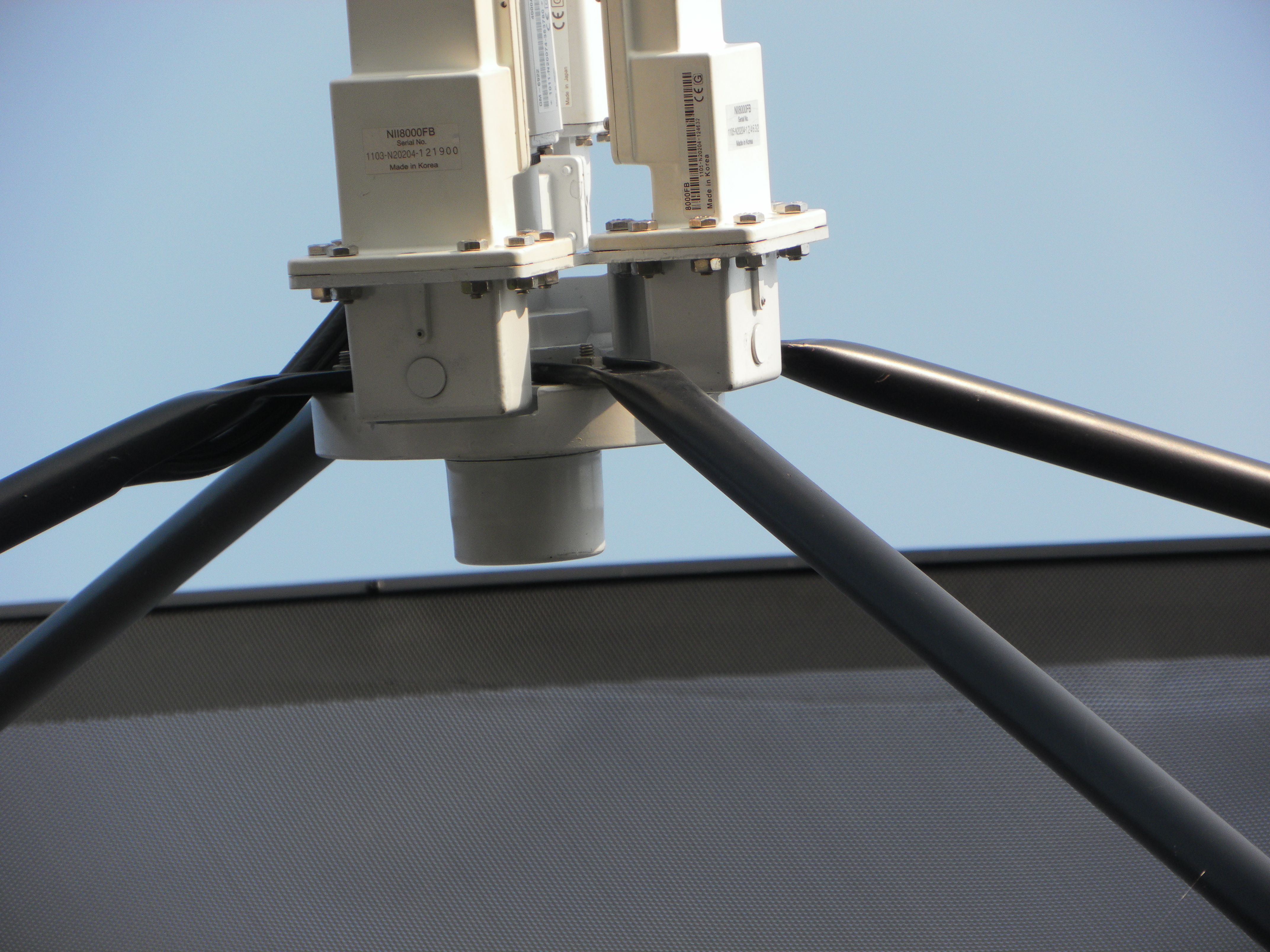

I have put a lot of thought into that very same question. I have a Winegard Pinnacle with a Bullseye II on it. My thought would be to use the ASC1 with a Corotor II Plus instead of the Bullseye. The reason primarily is that the Pinnacle is a very deep dish .278 F/D ratio. The Bullseye II is not designed for that kind of dish. In order to get maximum signal from the Bullseye you have to carve up the feedhorn a bit and take some pieces out of the scalar.
This does work good but the Corotor would be more versatile and can be focused better.
