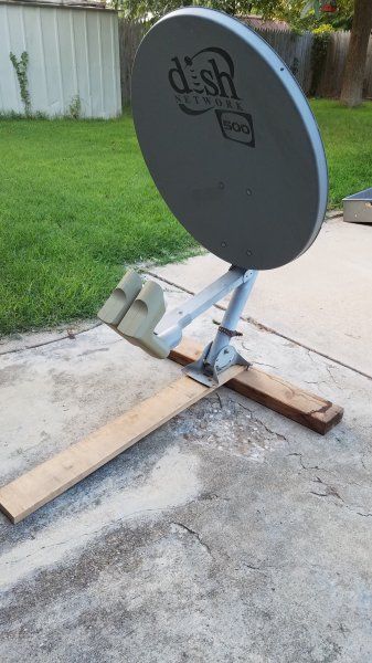

Here's my setup, setting on the back patio. I'm going to deliver it to my brother's house in a couple of weeks so he can get wi-fi from another brothers Windstream Wi-Fi router next door. The problem is the two houses are situated on 3 lots and from this antennas location to the Wi-Fi router it's about 200 ft, through 3 walls, one of them is stucco. He gets signal with a usb wi-fi receiver near the window but only 1 or 2 bars, I hope the reflector can boost that to 4-5 bars.
I took the reflector out in my back yard near the corner of my lot about 60-70 ft from the router in the house and pointed it roughly toward the router. You can see the corner of the lot just above and to the right of the dish where the Virginia Creeper is invading over the fence.
I used my cell phone wi-fi to see how the signal was effected.
Standing beside the reflector my phone had about 2 bars of signal on wi-fi, but when I placed the phone down near the front of the lnbs it jumped to 5 bars.
Old timers will recognize the old style Dish lnbs, I plan to place the usb wi-fi dongle between the two lnbs , there should be enough side pressure to hold it in place with no adhesive needed.
This will be an indoor install.
