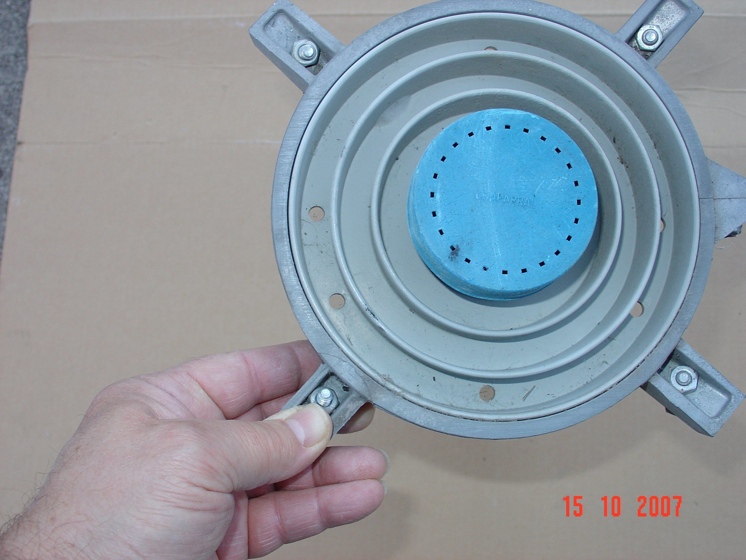

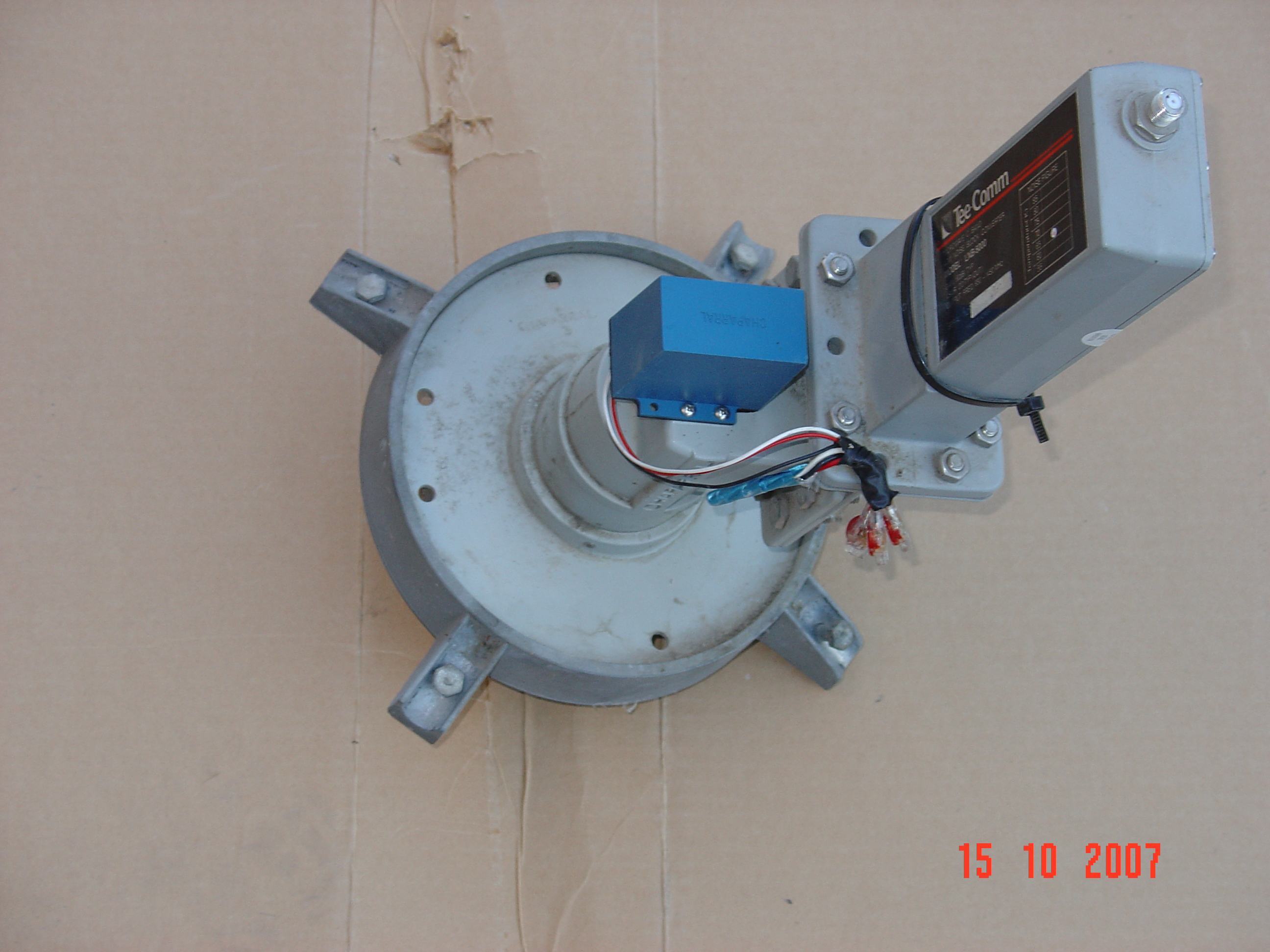

Can my existing Invacom QPH - 031 be adapted to work with my old existing Chaparal and T-Comm LNB Setup for my 12 foot Dish? See Pics. Has anyone tried this setup since it now works for Combined C/KU Satellite channels on 72.0W / AMC6/C, and 101.0W AMC 4/C on my 1 meter Fortec Dish?

although it will work. you would get better signal quality off the small dish where it is now than you would for the big dish. the QPH-031 is made for an offset dish and the big dish is a prime focus. now if you got the QPF-031 and the special feedhorn then it would work
there are cheaper solutions for a big dish prime focus ku lnbf.
the t-comm lnbf should work it probably won't get great signals but should still work ... you can also just upgrade your lnb on that feedhorn and have c-band side fixed ... you have a seperate setup for ku , i know a rig that gets both is a bit better but you can always upgrade. i currently watch more digital c-band than ku.

Thanks George, and thanks again for sending me that wonderful Satellite Ribbon Cable. Is there any info on that "QPF-031 and the special feedhorn" that you mentioned and would it allow me to pick up the C Band Satellites that I cannot get with my 1 Meter Fortec Star Dish??
The "QPF-" has a flange for their optional feedhorn that works with your big dish:
ADF-120 Adjustable feedhorn
For more discussion, search on "QPF" and my name.
I've posted about it several times this year.
All the technical info has been discussed, and should hopefully be clear.
AND, there are (two?) other cheaper alternatives (Ku LNBs) which'll work.
They were pointed out by other posters in the same threads.

jsattv you might set it all up with the t-comm and test drive it and later add a better lnbf
thats the cheapest solution ( the qpf isn't a cheap solution) and its ku only

Thanks Gabshere, Anole, and Lumpkin666. Great info Anole. George I think your suggestion of first trying my existing Chaparal Scalar and Tee-Com LNB is a good one - just to see if my new 12 Footer Dish works with everything else. Wonder what I will be able to pick up with the Tee-Comm - just C Band only? Thanks for your generous offer for testing out the BSC 621 hope your health gets better.
