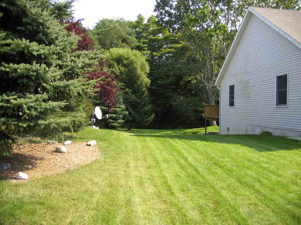

Here's a shot of the south side of my place, with two motorized dishes ( you can "just" see my second lnbf ) . The house next door doesn't impede my reception at all .
If you let us know your longitude, we can suggest a particular transponder to concentrate on.
