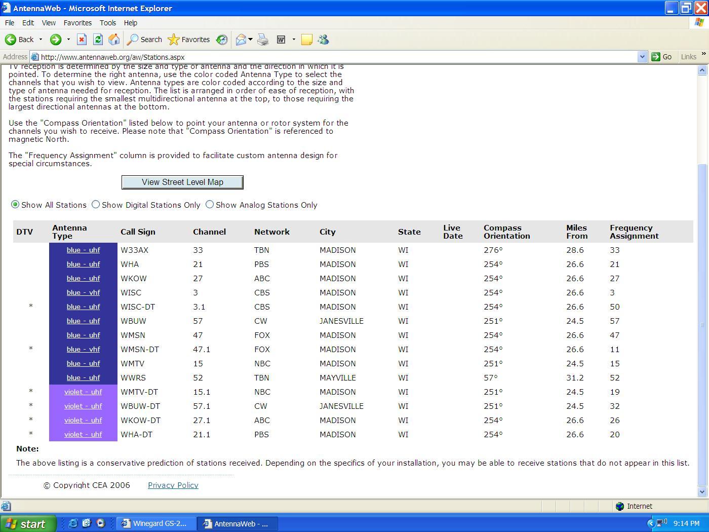

Here is the station and antenna info from antennaweb.
I should have also mentioned that my house is surrounded by woods with trees that are significantly taller than the roof of the house. I think that is why antennaweb gave me violet and blue for my stations.

h2oski said:
What do you guys think about this antenna for my application?
Antennas Direct V15
Looks like it is not enough antenna. Medium range antenna for a fringe or deep fringe application. You can NEVER recover from too weak an antenna with amplification.
If the antenna web results you supplied are any indication of your true antenna needs at your home...you will need a fringe antenna solution.
Your ch 11 digital is rated blue on antenna and I rule the cm4228 out since it may be a risk for stable reception on that channel.
Therefore suggest a fringe rated combination vhf /uhf antenna
Winegard hd7084p (minimum) or hd8200P with hdp269 preamp
The antenna examples you pointed out to us are not rated for the reception challenges you face.
