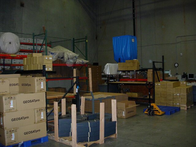

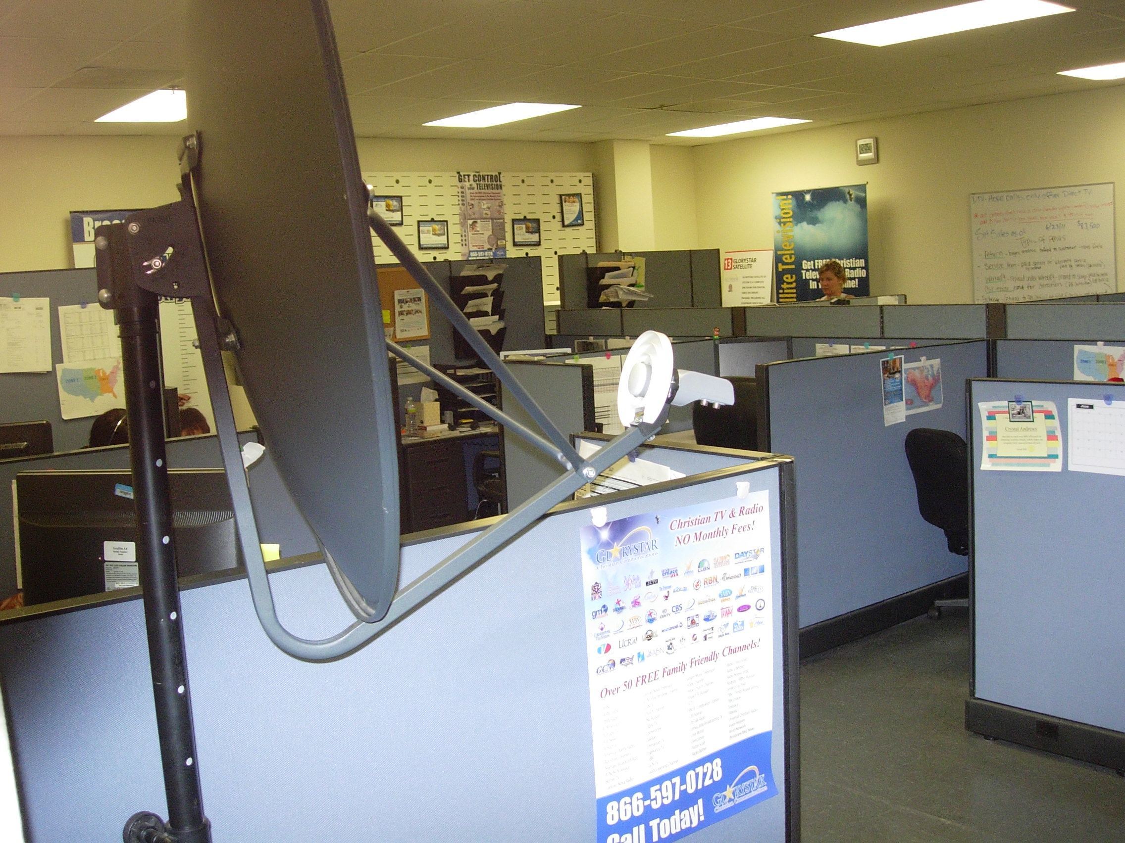

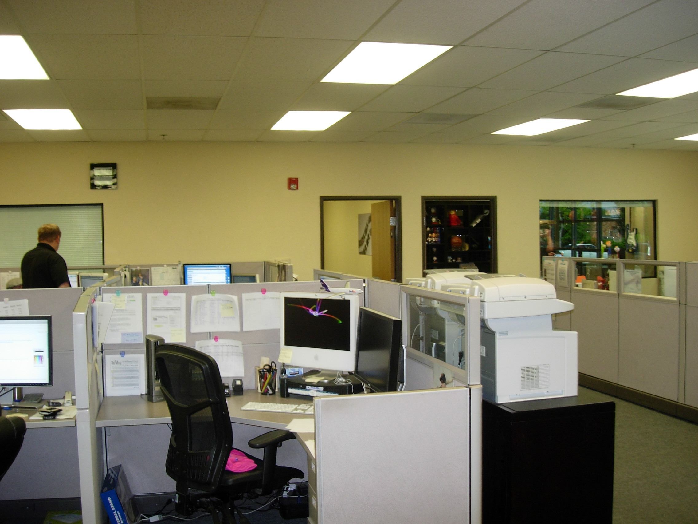

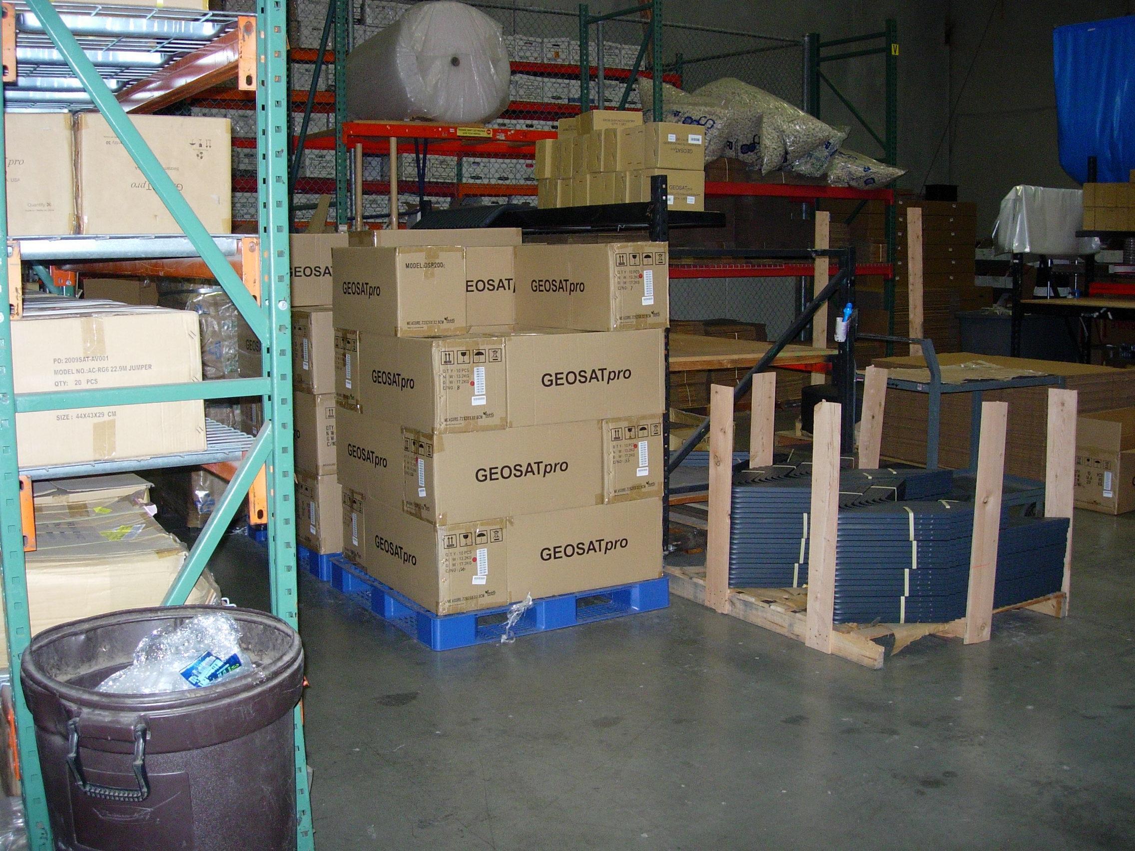

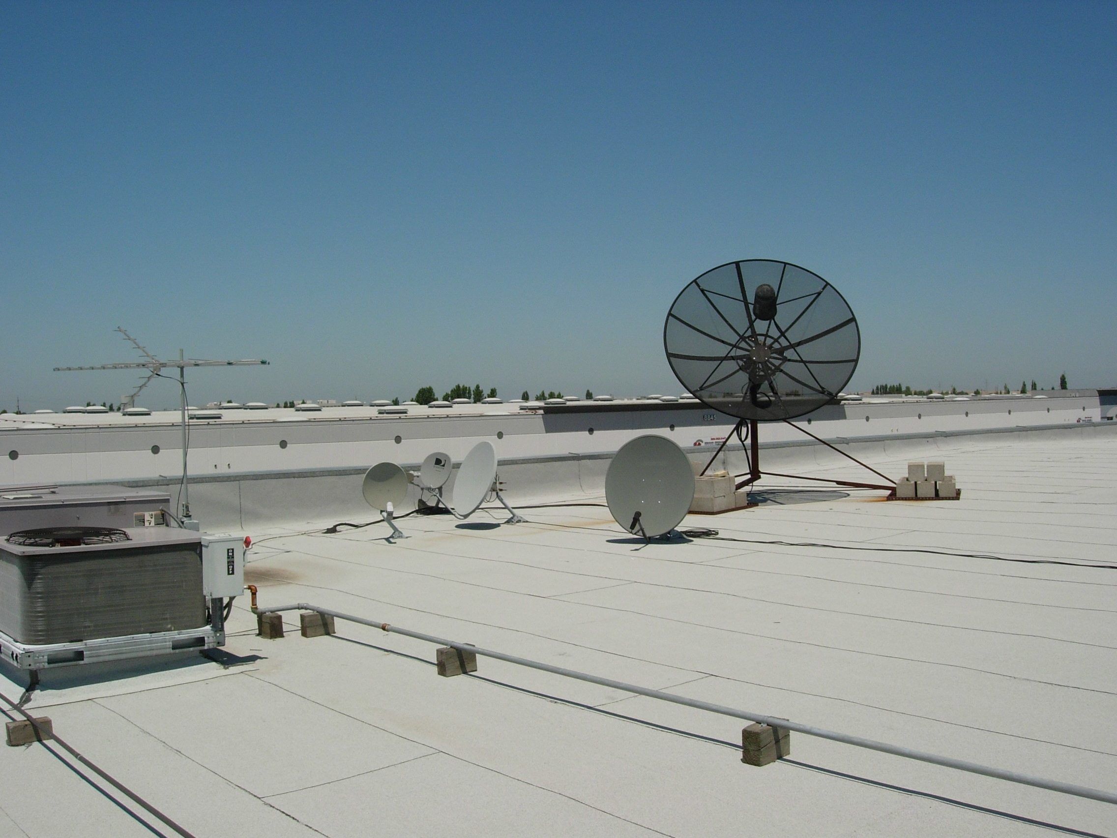

Just got back from a very nice visit with Brian at his Office / Wharehouse. I have uploaded a couple of pictures I took while ( wish I had taken more but was too busy ;-) There is one of Brian at his workbench.. me in front of stack of dishes (amazing how they are shipped in ) There are a couple of pictures of the main area when you walk in the door and another of the Sat area.. Also there are some pictures of the wharehouse where some of the preparation for shipping out orders are done.. There is also a picture of some of the dishes that they have on the roof and sorry I did not get pictures of the ones out front on the ground level.
