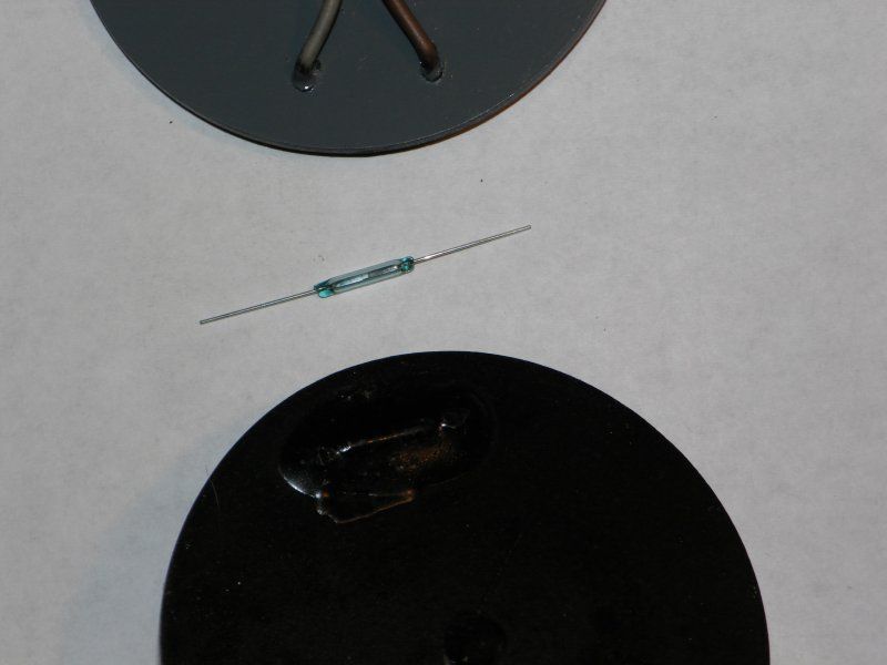

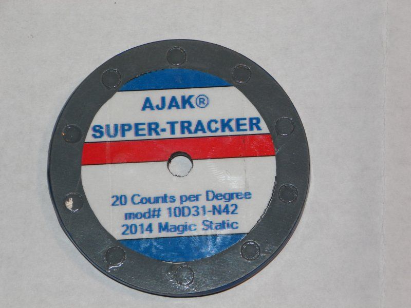

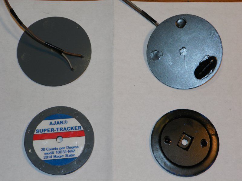

Magic Static do you sell this Ajak Super-Tracker? I would benefit from this improved reed sensor. Let me know how to buy if you have them for sale.
Correction - should have said that my 12 ft mesh dish would benefit as my motor only has 5 magnets and I use it for C band and Ku band
