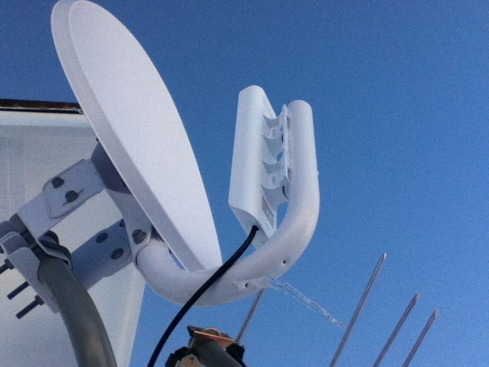

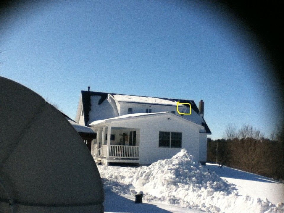

I have yet to hear from my internet provider regarding the frequencies, but the cable for the C Band dish is buried and enters into my basement, so the cables shouldn't be the problem. I am attaching pictures of the setup if that helps clarify things. Thanks again for your help!

If the yellow 'circle' indicates the WiFi antenna, then the C-Band dish is almost pointing directly at it. Titanium's idea of a chicken wire or other metal mesh screen may be the easiest way to stop the interference. You will probably want to wait til the weather is better to get on the roof and try the idea.
Alternatively, remounting the WiFi antenna dish on the chimney, out of sight of the C-Band dish may also prove to solve the problem, if it can still get the Line of Sight to the provider while not be in the line of sight of the C-Band dish.

Agree with migold and jmag487. There is a terrestrial C-band transmitter installed in front of your satellite dish! :eek:
The smaller C-band dish will not have a very tight beamwidth and the WiFi signals are probably reflecting directly into the feedhorn. The C1-PLL is at a soft cut at that frequency and will attenuate pesky side lobes, but this is head-on.
Little that can be done to build a RF fence without limiting the performance of the WiFi. I would have the WiFi antenna relocated.
Yes, the yellow circle is the location of the wireless setup. And unfortunately I don't have a lot of flexibility with the wifi setup and that is about the only location where I have line of sight to the tower for that. I did a quick search and was wondering if any of these C-Band filters (eaglecomtronics, dawnsat) would help at all? As you can see from the pictures we are kind of buried in snow right now and the diagnostics are a little more difficult!

Looks like this is going to be difficult! The only other spot that I MAY be able to still hit the wifi tower with the antenna is located about 15 to 20 ft north of the C Band dish. It would be pointing at more or less right angles to the C band dish, but I imaging that will probably still interfere :( I'm not really clear on the whole fence thing. Where would that be located with my current setup?

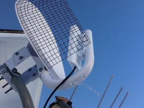

I'd be gettin some 'hardware cloth'. ~1/4 inch mesh and mount it right on the side of the I-Dish. Rivet or screw it to the lip. Ground is 'taken care of'.
attachment.php
EDIT: 'N hope there's no trouble with snow filling it up.
EDIT 2: Maybe just clamp it on to see if it works?????
