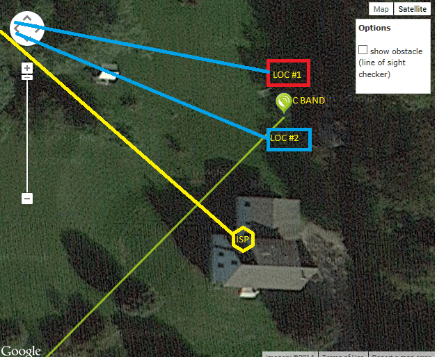

Oh well. I tried the shield approach and it did absolutely nothing. It seems like the problem might be that the signals for the C Band and the ISP are crossing directly into each other's path. My options are extremely limited, but I will see if I can move the ISP dish when things thaw out. I have attached a picture with where I should be able to move it, but again, with trees, buildings, etc. I only have a couple of routes to their tower. Unfortunately both locations are physically closer to the C Band dish, but one of them will not cross. Any thoughts?

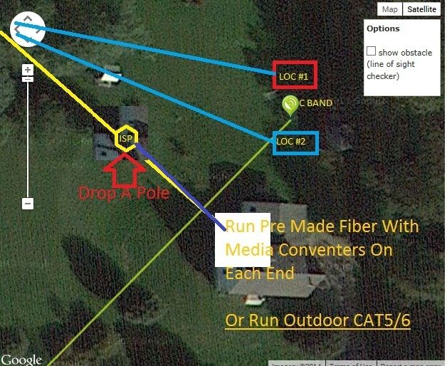

A couple of things to investigate in advance that might help when it comes time to try finding a new location.
Ask your ISP what is the maximum length of cable they will support from the device outside to wherever you need to terminate it at a device inside. Ethernet is 330 feet but this may not apply here where you appear to need Power Over Ethernet out to the Dish Bridge.
Also ask them if you can rent or borrow just the Dish Bridge for a couple of weeks. I am assuming that the outside components are dumb and do not require any software configuration.
If you can just swap out the antenna while you temporarily run a length of Cat-5 to the inside of the house, this would allow you to test the yard for other locations while allowing you to revert easily to working internet.
Perhaps just moving farther out along the yellow line will work.
I would drop a pole and run fiber or CAT5/6.

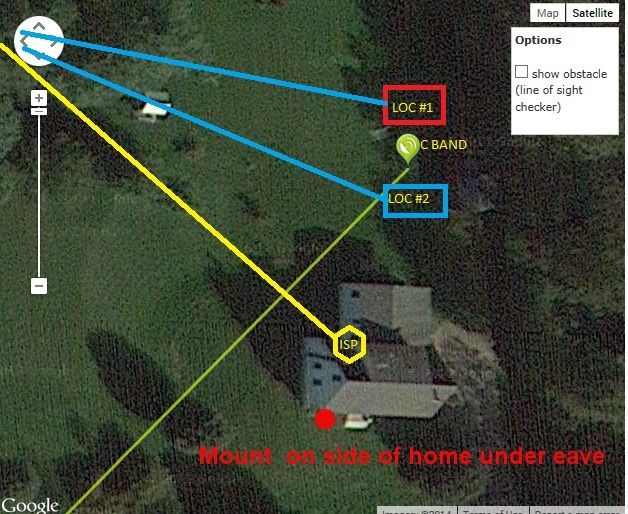

Could you mount on the far side of the home and use the house as the RF barrier? It does not matter that the two signals cross. That will not cause interference. The WiFi antenna needs to be out of the line of sight from the C-band dish.
