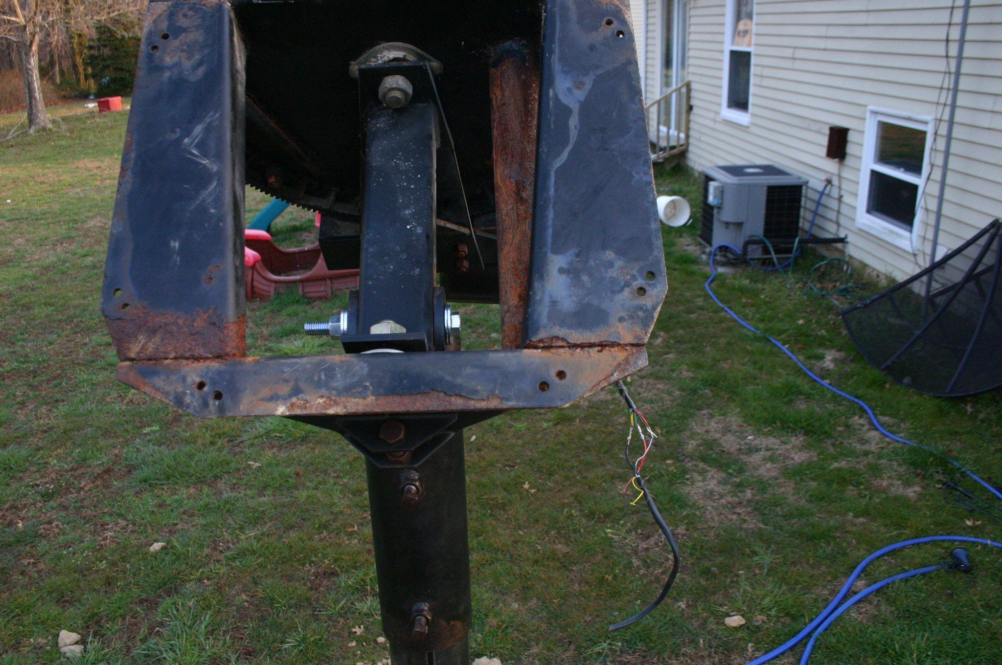

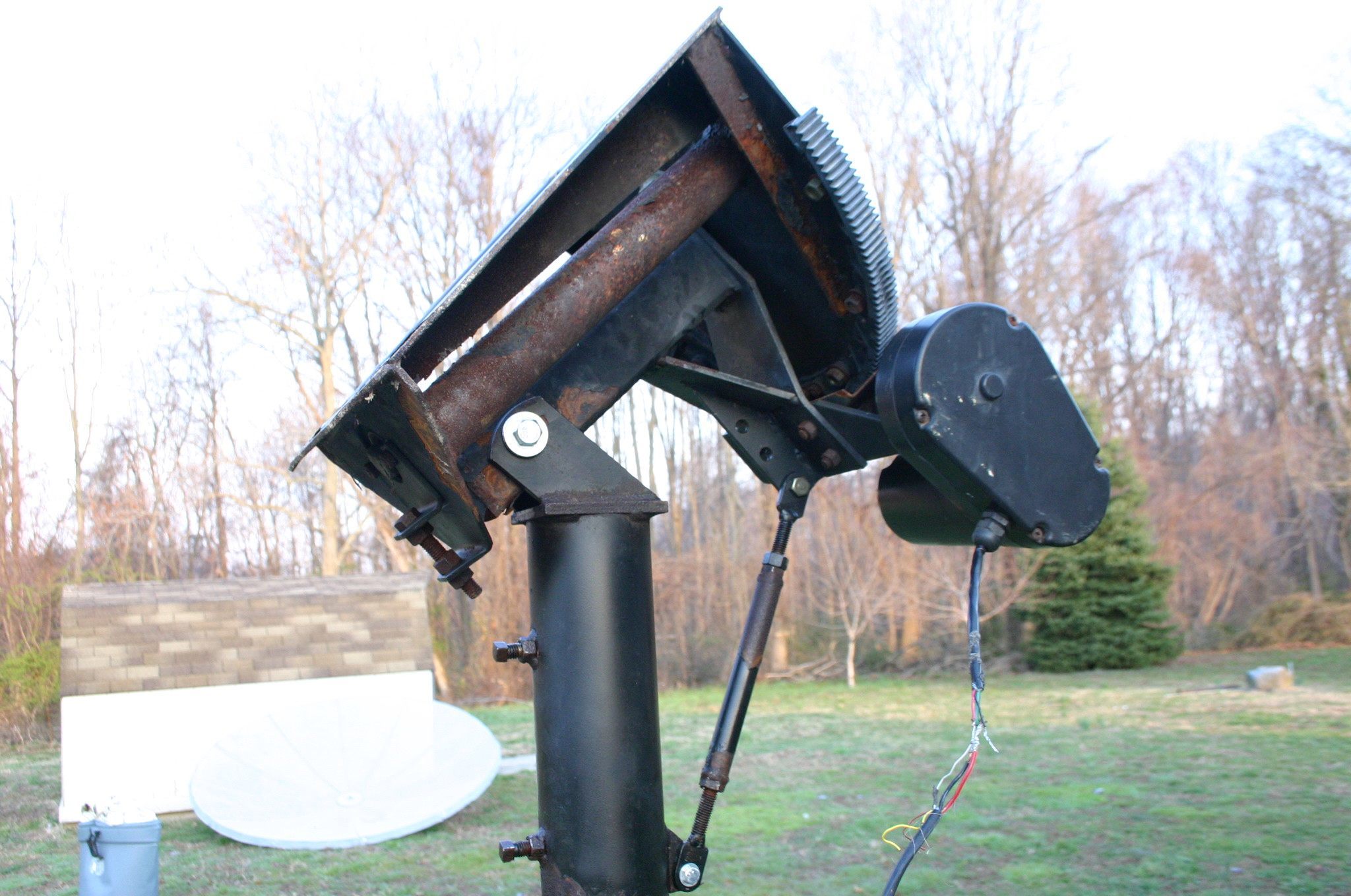

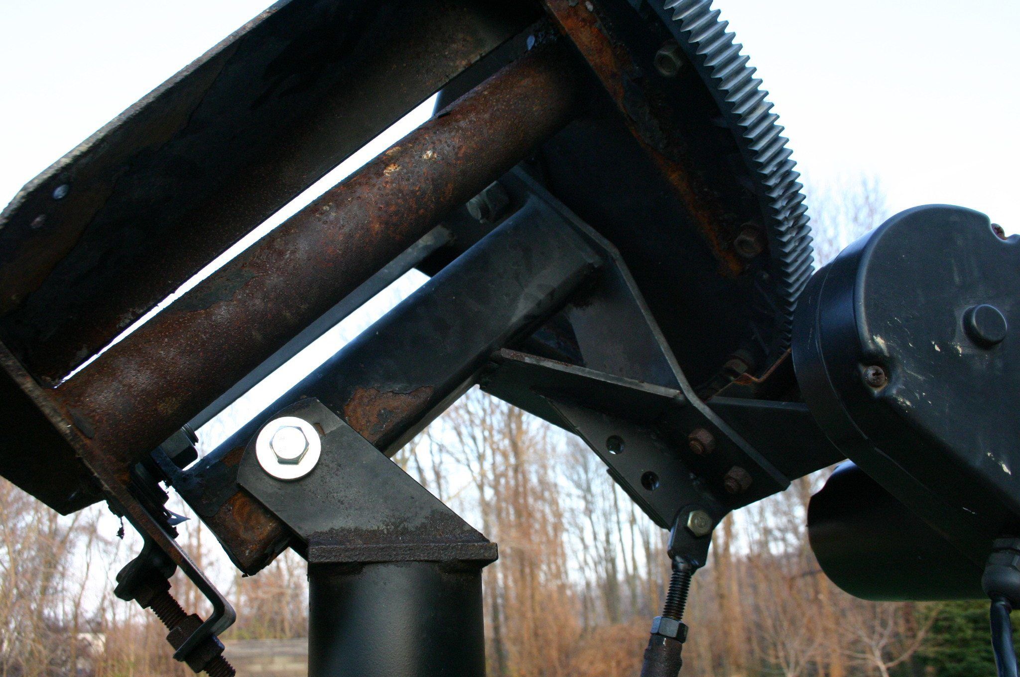

I have attached 3 photos of the H to H mount. Has anyone worked with a mount like this?
The mount appears to be tilted to an elevation of 45 degrees. I need the mount to be at 43 degrees.
I assume that the threaded bar on the back side of the mount is used to "fine tune" the elevation (see first pic).

It looks to me that the turn buckle is your elevation setting. The captive bolt looks to be your declination setting. If you got the dish anywhere near your place, the declination setting should be pretty close if not dead on.
The declination effects how much curve is on the arc that the mount will move through.

I got this from a guy about 40 miles north as the crow flies. The elevation difference between that location and mine is about 1 degree. So I think I will be really close. I might try to fine tune it once the dish is in place.
