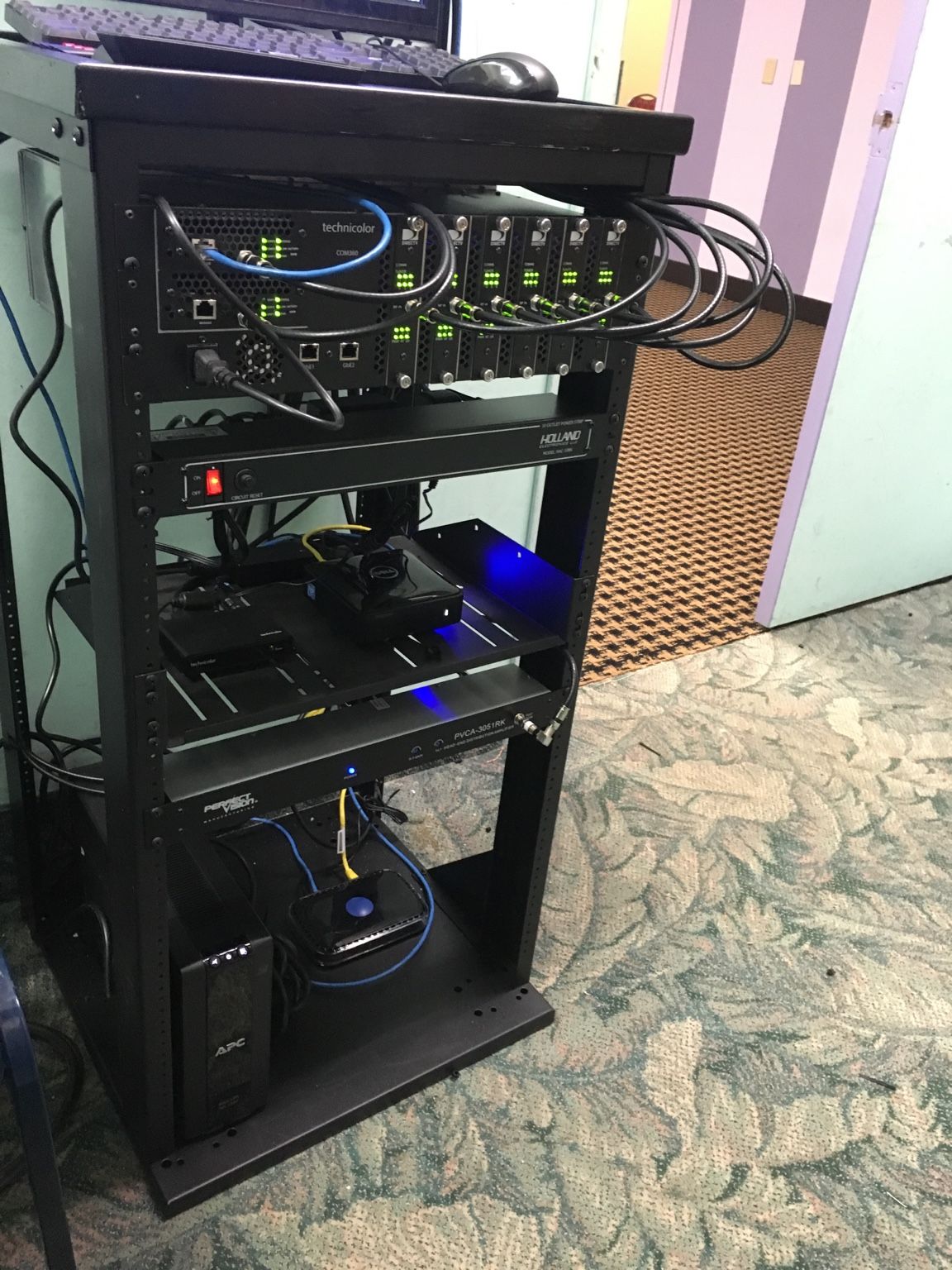

im doint a sollege project, the main idea is of course if is possible) to take from a directv receiver with a paid subscription (of course) and trough some device or software to every single channel that i am paying for to open it in a media player like vlc or in any media player.
the idea is to open it all at the same time in a pc.
thanks

No, can't be done like that. Each directv tuner only decodes a single channel, there's no way to take them all at once and do anything useful with them (since the signals are encrypted)
well, if you're needing to watch more than one channel from this receiver at once, then no. however, using the HDMI output i think i've figured out a way to record the stream onto a computer. costs about $1500 in parts though. purely theory at this point since i've not pulled the trigger to try this experiment though.
what channles?
Specifically it's referring to a com2000 headend system like in the photograph.
Which is comprised of "com46" plug in modules. Where each module can simultaneously receive up to 8 different DIRECTV program channels, and the chassis they plug into can accept up to 6 of these modules.
Therefore 8 x 6 = 48 channels max.

What you want to do was sort of possible with cable. A multi stream cable card pci-e card could be put in a computer. Then up to 6 channels could be watched/recorded on the computer from the cable connection if the cable card supported 6 streams.
With directv the closest you can get is 2 channels with PIP on a genie. If you do not need to do things real time, using a genie you could record 5 channels at once and play back the shows that are important to you and record them to the computer. Then you could tile the recorded files while you played them back. Unfortunately you would still be limited to getting 24 hours of video out in a day without paying extra for more clients or receivers.
Hauppauge makes several products that would let you get HD video into a computer (the HD PVR line and the Colossus line). With a couple of those and a stack of satellite receivers you could get a bunch of channels into a computer real-time and display them, but for every channel you want to show you need a subscription for a box.
If you need to build something to show proof of concept, SD capture devices are cheap. In place of directv boxes you could use FTA boxes or OTA DTV converter boxes.
