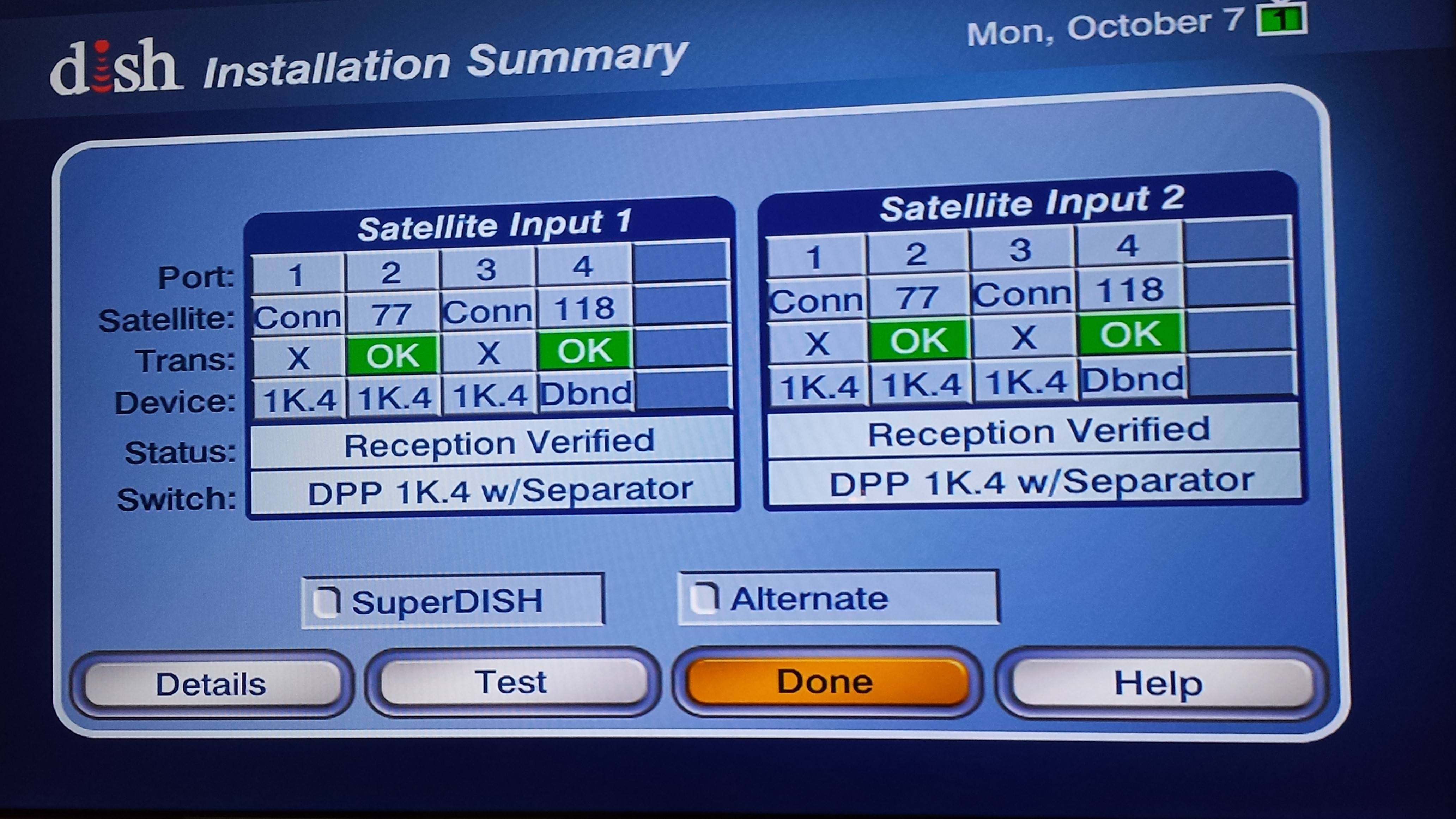

Could be. When you run the check switch it should come back with four boxes. Which two are blank?
Okay, I think you all are right... Now I am thinking again that it is misaligned.
Block 1 and 3 are blank. Block 2 says 77. Block 4 says 118.

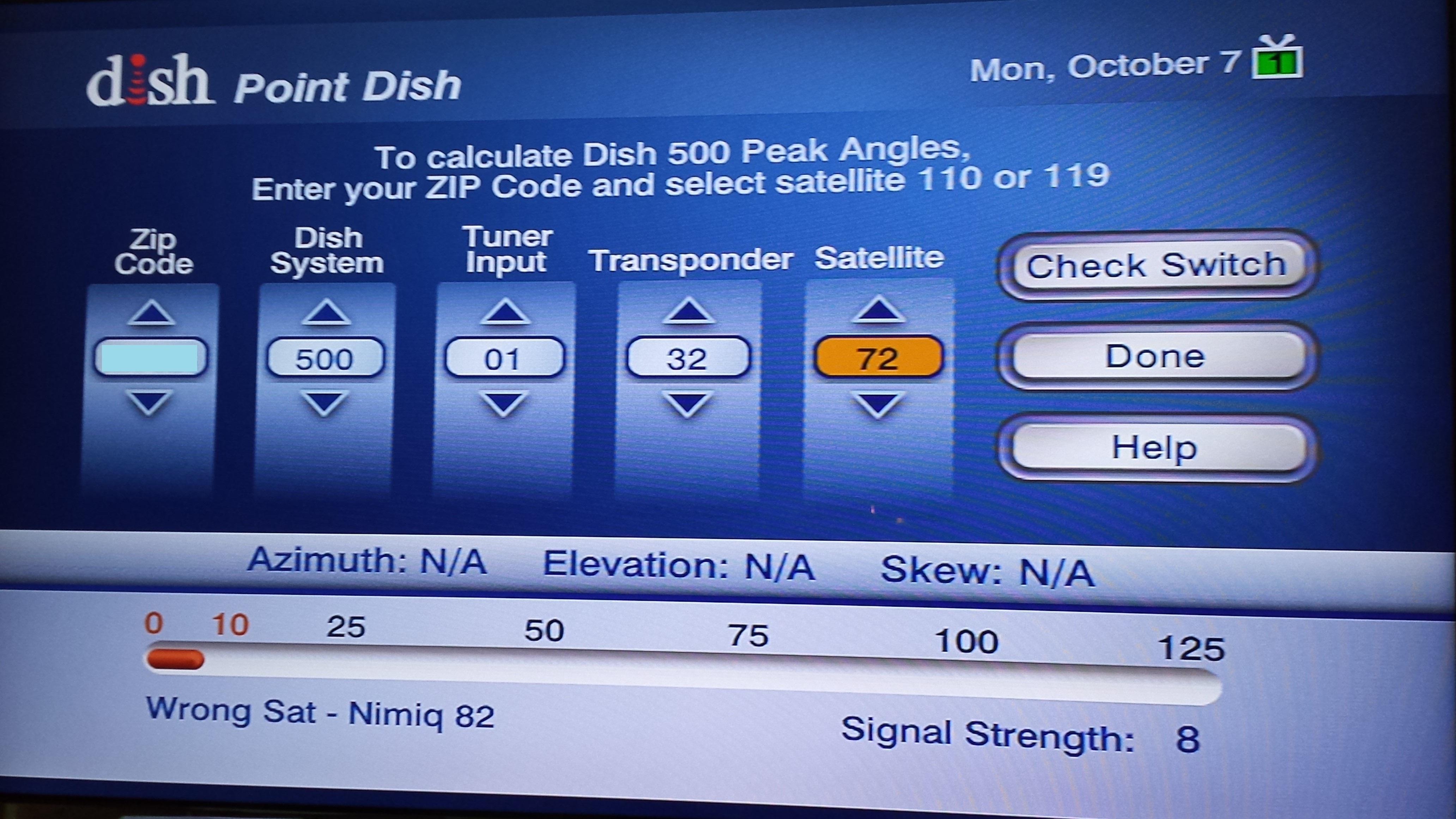

If I recall, I think 77 used to be in Block 1, right? Also, when I do a signal check - I get locked on 118 and 77, but when I go to 72, tp32 - I get a very weak Wrong Sat - Nimiq 82.. I don't know how I found myself on tp32 since I usually test the signal on tp9 or 15.
So, perhaps if I can turn the dish clockwise I might be able to find 72? Do I have that right?
