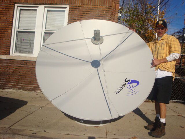

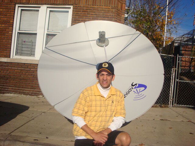

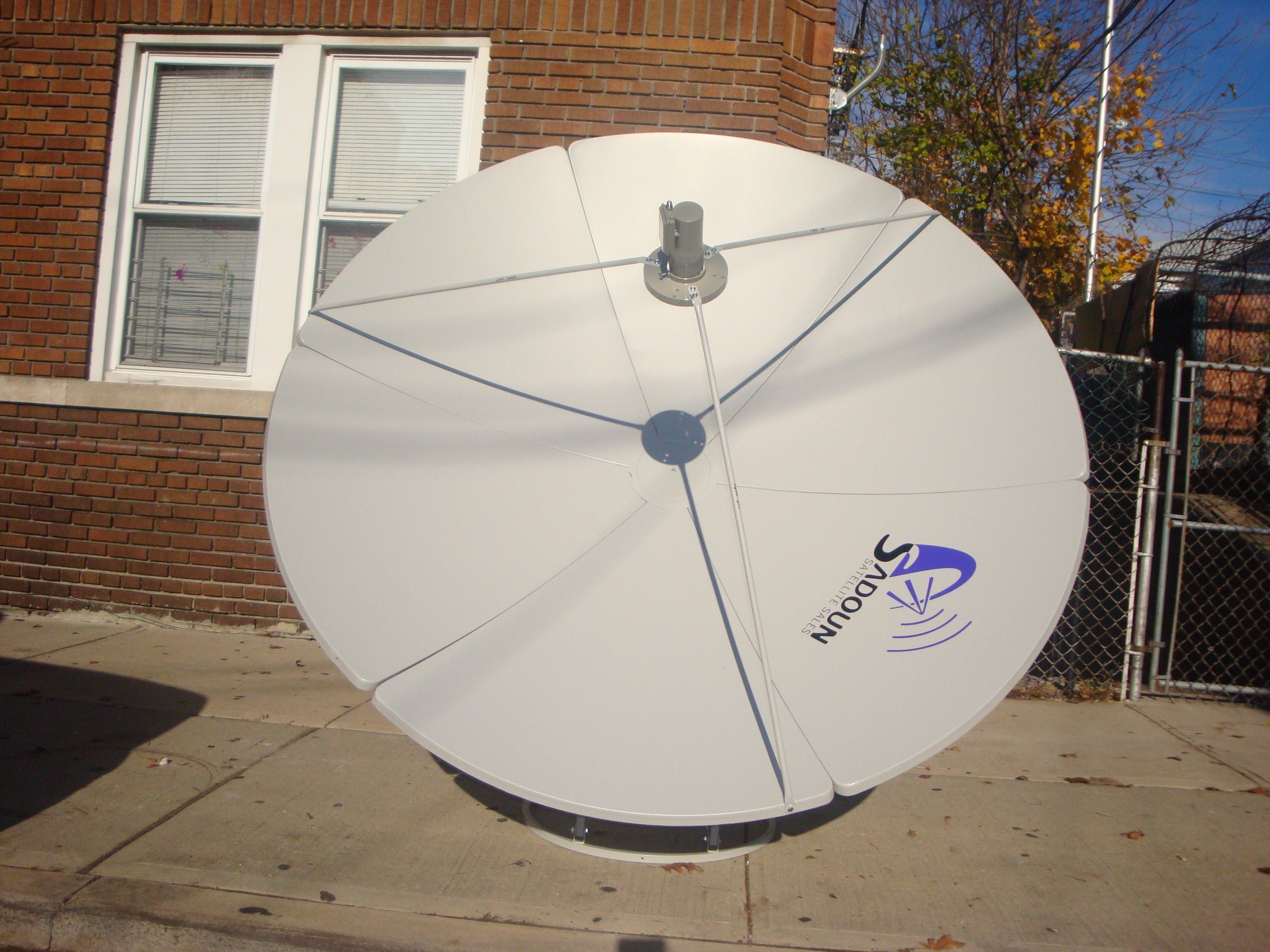

hi guys finally got my first dish ( 6 foot ) is really easy to assemble and signal Quality is really great. I got 37.5W,43W ,45W,55W,58W,61W( Amazonas). Maybe later i'll try to get the c-band circular and after that start with the 87 W
to 125W i hope i get all. this new dish model from Sadoun is the best.
got some pictures.
:):) Hope u guys like them.
I keep post it the others satellites ,which of them i can get. :)

WELCOME to the real C-Band club Manny :)
I've got 3 of those 6 foot dishes (2 Fortec 1 Sadoun) and they rock.
So now you shouldnt have any issues getting MetroTV now ;)
Looks like 40.5W has a ton of circular polarity signals on it

all you need to do is put the dialectic plate down the throat of the LNB to get circular. If you dont have it, I've seen folks use like a credit card to make it work :)
If you take the cover off the LNB you'll see 2 sets of grooves on each side. That is where it goes to make it a circular polarity LNB
Nice dish.. and like ICEBERG said, welcome to the C-Band club.

hee hee noticed you have the Sadoun logo at the bottom of the dish
I think all of my C-Band dishes have the logo at the bottom too ;)
